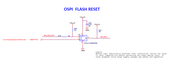

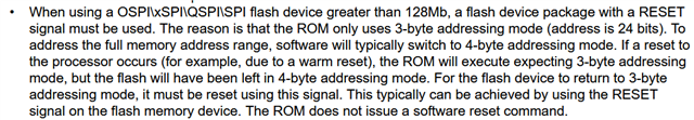

    3. ANDing logic for OSPI reset
    The ANDing logic provides flexibility to reset the attached memory device including performing a local reset when the attached memory device becomes non-responsive or when the processor goes through a warm reset. Refer SK schematics for implementation.
    RESETSTATz output will satisfy the power-on and warm reset functions and can be used to reset the attached device. Ensure IO level compatibility between the RESETSTATz output and the attached device reset input. You will need a two input AND gate to insert the software controlled GPIO reset function for the case where software needs to initiate a reset to only
    A pullup and an isolation resistor is recommended for the SoC IO output connected to the ANDing logic near to the AND gate.
    When ANDing logic is not used, verify the IO compatibility of the SoC reset status output used and the attached memory device.
    In case ANDing logic is not used and the processor Main
    Domain warm reset status output (RESETSTATz) is used to
    reset the attached device, ensure the IO voltage level of
    the attached device matches the RESETSTATz IO voltage
    level. A level translator is recommended to match the IO
    voltage level. A resistor divider could be used
    alternatively, provided optimum impedance value of the
    resistor divider is selected. If it is too high, the
    rise/fall time of the attached device reset input could be more and
    introduce too much delay. If it is too low, it will cause
    the processor IO to source too much steady-state current during
    normal operation.

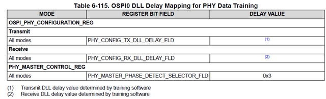

    Tap mode or PHY mode
    OSPI0 offers two data capture modes, PHY mode and Tap mode.
    PHY mode uses an internal reference clock to transmit and receive data via a DLL based PHY, where each reference clock cycle produces a single cycle of OSPI0_CLK for Single Data Rate (SDR) transfers or a half cycle of OSPI0_CLK for Double Data Rate (DDR) transfers. PHY mode supports four clocking topologies
    for the receive data capture clock. Internal PHY Loopback - uses the internal reference clock as the PHY receive data capture clock. Internal Pad Loopback - uses OSPI0_LBCLKO looped back into the PHY from the OSPI0_LBCLKO pin as the PHY receive data capture clock. External Board Loopback - uses OSPI0_LBCLKO
    looped back into the PHY from the OSPI0_DQS pin as the PHY receive data capture clock. DQS - uses the DQS output from the attached device as the PHY receive data capture clock. SDR transfers are not supported when using the Internal Pad Loopback and DQS clocking topologies. DDR transfers are not supported when using the Internal PHY Loopback or Internal Pad Loopback clocking topologies.
    Tap mode uses an internal reference clock with selectable taps to adjusted data transmit and receive capture delays relative to OSPI0_CLK, which is a divide by 4 of the internal reference clock for SDR transfers or a divide by 8 of the internal reference clock for DDR transfers. Tap mode only supports one clocking topology for the
    receive data capture clock. No Loopback - uses the internal reference clock as the Tap receive data capture clock. This clocking topology supports a maximum internal reference clock rate of 200 MHz, which produces an OSPI0_CLK rate up to 50 MHz for SDR mode or 25 MHz for DDR mode.
    OSPI0 PHY Mode supports data transfer With PHY Data Training or OSPI0 Without Data Training
    OSPI0 Tap Mode supports data transfer Without Data Training
    Please refer to the OSPI timing section in the latest processor-specific data sheet to better understand the modes supported.

  • Hi Board designers,
    Input related to OSPI0_RESET_OUT0 and OSPI0_RESET_OUT1 usage
    When OSPI flash memory is not used for Boot, the RESET_OUT[1:0] signals can be used to reset the OSPI flash. If OSPI flash is
    used for Boot, the flash needs to be reset in tandem with SoC PORz, thus the OSPI0_RESET_OUT[0:1] signal should not be used.
    Flash Reset
    OSPI provides Flash reset out ports. These ports are active low and controlled thru OSPI_CONFIG_REG
    register.
     OSPI0_RESET_OUT0 and OSPI0_RESET_OUT1 reset output perform similar functions as a GPIO used in the SK to perform reset.
    Advantage using OSPI0_RESET_OUT0 and OSPI0_RESET_OUT1 is the IOs and the control is part of the IP.
    Input related to PYH_MASTER_PHASE_DETECT_SELECTOR_FLD in PHY_MASTER_CONTROL_REG in FSS0_OSPI_0
    And could you explain more specific about PYH_MASTER_PHASE_DETECT_SELECTOR_FLD. What will be affect after change the value of this register?
    The implementation is internal to the IP and we may not have any other simpler implementation to explain
     this field is for synchronizing the reference and sampling clock for phy mode. It adds the necessary delay to sample the data to send to your flash.
    The register is automatically configured by driver or should customer configure this register by manually or sysconfigration for custom board?
    Data sheet reference:
    The PHY implementation has timing variability that is unique to each circuit layout.  The PHY_MASTER_PHASE_DETECT_SELECTROR_FLD provides a way for the design team (internal to TI) to adjust an internal timing parameter for optimum performance.  Given this is internal to the processor, customer is not expected to understand how this adjustment functions, and we have no plans to describe its function.  The recommendation is for the customer to set the value defined in the datasheet to ensure the device works as expected.

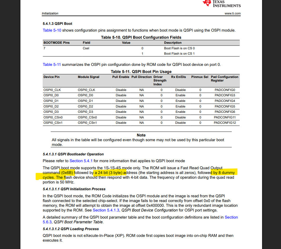

  • Hi Board Designers,
    Input related to QSPI boot and TAP delay setting
    The QSPI boot mode will boot with Tap mode, no loopback (PHY mode disabled)
    Thee is Internal reference clock with Taps that the Boot ROM supports with QSPI, OSPI and XSPI(With PHY disabled) boot modes.
     For QSPI and OSPI boot, OSPI0_CLK frequency is 50MHz (Where internal reference clock is 200MHz). ROM has a way of learning the optimal tap settings, which is configured during boot.
    While for xSPI boot without PHY, OSPI0_CLK frequency is 25MHz.
     https://e2e.ti.com/support/processors-group/processors/f/processors-forum/1548732/am625-qspi-boot-up
    AM625: QSPI boot up
    I understand from the e2e description of the question, that you want a customized ROM code which adapts to the flash which you are using.
    Currently, the ROM code updates cannot be made. Rather any customization can be done on application/bootloader level, which is using the MCU+ SDK kit. So the current suggestion is to read TRM on how booting happens and what commands are sent, based on which the flash is decided.

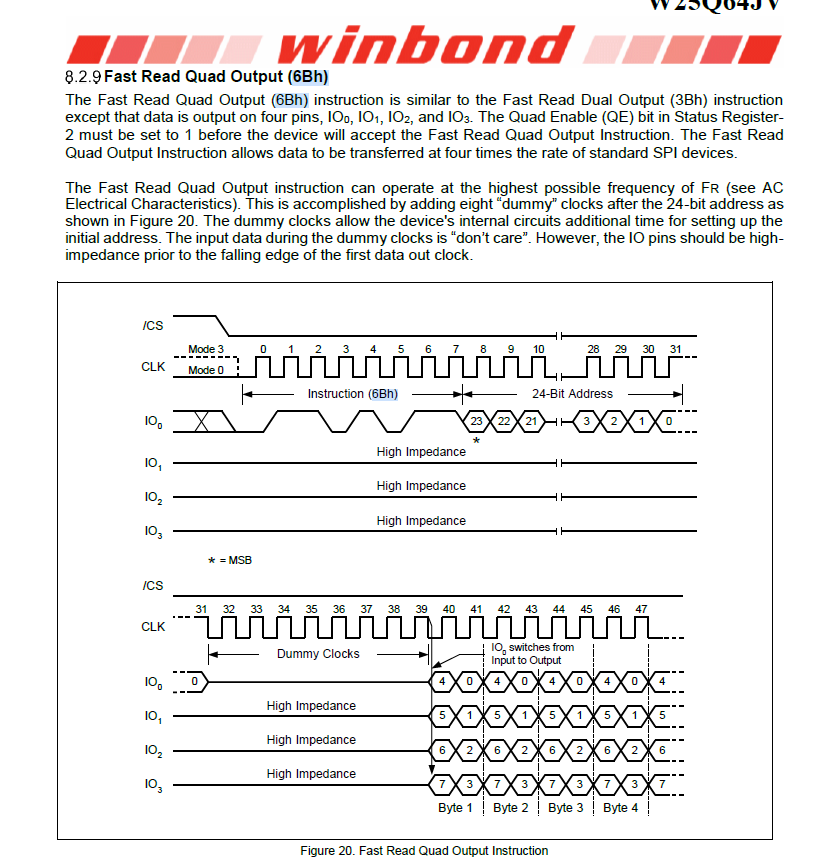

    Also take into account the following:
    Many QSPI Flashes requires has QE bit, or the Quad Enable Bit. This is an important factor to consider as ROM does not set the QE bit.
    One more thing to take care of is, in QSPI bootmode 3 byte address is required to be sent out and not 4 byte. Same follows for SPI bootmode.
    So, suppose you are at application level and currently your flash is operating in 3 byte addressing mode. At a certain point if it is made to work in 4 byte addressing mode, then when you exit the application the flash might be left in 4 byte addressing mode.
    And then when you try to boot from this same flash the next time, it will not boot, as 3 byte addressing is required but the flash was previously left in 4 byte addressing.
    So, a good practise, is to make sure before booting, we need to make sure flash is in 3 byte addressing mode.
    https://e2e.ti.com/support/microcontrollers/arm-based-microcontrollers-group/arm-based-microcontrollers/f/arm-based-microcontrollers-forum/1574418/am2434-qe-1-quad-fixed-flash-device-for-qspi-boot
    Since the QE = 1 is fixed, hence it would be suitable to boot in QSPI Bootmode.
    Let us understand the reasoning in depth as to why the flash you are using will boot in QSPI bootmode.
    The Flash datasheet/spec says the following for the 6Bh command:
    If you see above, it says the command combination will be: 6Bh + 24 bit address(3 byte address) + 8 dummy cycles
    The same command is mentioned in the TRM under QSPI Boot section as well:
    An advantage is that QE bit is already set for your flash device, hence we need not explicitly set it.

    ROM does following when QSPI memory is connected.
    1. Reads Device ID
    2. Find the TAP Delay
    3. Program the TAP Delay register  OSPI_RD_DATA_CAPTURE_REG[DELAY_FLD].
    Are you saying that the TAP Delay is optimized using the flash Manufacturer's Unique Device ID?  Is that flash register first read at a slower rate with single SPI and then ROM starts iterating to find optimal TAP Delay using QSPI?  It would seem that there would have to be a high level of certainty of the actual Device ID value before adjusting TAP Delay.  Otherwise how would ROM know if it has achieved the optimal value?
    Yes right, in order to find the appropriate Read Delay Capture value, we need to be able to read a known value back from the flash, in this case the device id value. With these flashes ROM issues a ReadID command which can only be performed in 1S mode , after finding TAP delay & programming it ..then switches to 4S.
    The read Data Capture delay is adjusting to the middle value.
    This middle value is not random but the middle value for the passing region.
    For example, if the values 4, 3, 2, 1, 0 are being searched for and we see the green segments passing, then we pick the value 2.
    ROM code uses tap mode @ 50 MHz and not PHY mode.
    In ROM, the DEV_DELAY_REG is set to 0x0.
    What is actually used for tap mode is the RD_DATA_CAPTURE_REG DELAY_FLD bit[4:1]. For which we (ROM) scan all possible value to find the optimum setting.
    So for ROM only DEV_DELAY_REG does not matter.

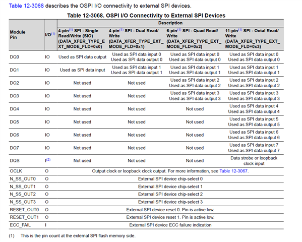

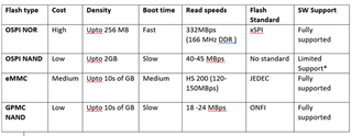

    a couple of quick general comments;
    • OSPI would be recommended for fastest boot; more parallel data lines == higher throughput
    • Highest frequency is defined in the device datasheet; you can run the OSPI controller/module w/ 166MHz bus speed in DDR mode; this is supported by the current driver. The SK-AM64B board is a good example of such a solution.
    • The higher speeds require the use of what's called "PHY Mode" which requires a careful HW design including the connections and clock signals and also requires only a single flash device to be connected (no muxing with different OSPI/QSPI devices using the chip select signals, also see AM6442, AM6422, AM6412 and AM2434 Schematic Design and Review Checklist for more background on this and other HW-related aspects)
    • The external loopback mode is only used for QSPI according to the TRM section "12.3.2.4.2 OSPI Modes". In case of OSPI, the external device provides a DQS signal for source synchronous capture.
    Please use this guidance for selection of the flash for your project:
    OSPI, GPMC interfaces are same across AM62, AM62A and AM62P. eMMC interface on AM62P supports upto HS400 projects and AM62/AM62A supports only HS200 speeds.
