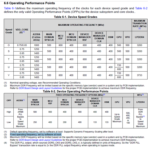

    Inputs related to OPP
    Data Sheet:
    The OPP is mostly a function of software. However, the operating frequencies defined in an OPP may or may not be based on hardware imitations. This depends on the clock in question. For example, many of the modules have clock frequency ratios requirements that must be maintained between clock domains for proper operation. So it is not possible to simply change a module’s operating frequency without considering these limitations.
    The table is defining what we have internally agreed to support as valid operating points since we do not allow customers to change operating frequency of the various modules. Allowing customers to change frequencies outside of these OPPs would require us to define the clocking limitations of every module. In most cases these limitations have multiple dependencies which can be very difficult to define. In the past we have found this approach is problematic as customers may not fully understand and check the limitations. This results in the customer configuring the device to invalid operating condition. So we simplified the number of options supported by defining specific OPPs.
    No, that pretty much sums it up.
    For example, even though the processor core can technically operate from across a wide frequency range, we didn’t want to give the customer free reign on picking any operating frequency. OPPs are finite voltage/frequency operating points that the customer can choose from. These have been tested by software over the years, so there’s really no reason for a customer to deviate from these.
    I see the below in the data sheet
     FIXED OPERATING FREQUENCY OPTIONS (MHz)(2)
    (2) Fixed operating frequency, set by software at boot
     and TRM
     6.2.3 Power Management Techniques
    The following section describes the power management techniques supported by the device
    6.2.3.1 Dynamic Frequency Scaling (DFS)
    DFS is a power management technique where the operating frequency is dynamically scaled across device
    Operating Performance Points (OPP). An OPP is a voltage/frequency pair that defines a specific power state.
    For each OPP, software controls clock frequency in order to adjust the performance and power to the optimum
    point. The Device supports DFS for Cortex-A53 only.
    6.2.3.2 OPP Low
    The device supports lower bus frequency operation as OPP Low. The OPP Low must be configured at boot time.
    In OPP Low, the main CBASS clock frequency is reduced in half in order to lower active power consumption with
    reduced performance. The performance of some peripheral modules is limited or not available in this operating
    condition.
    Refer to the device datasheet to determine the supported features and the clock frequency of cores, modules,
    and peripheral I/Os in OPP Low

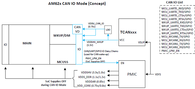

    (+) AM620-Q1: MCU Rail Definition in Voltage/Power/Clock Domain - Processors forum - Processors - TI E2E support forums
    "Partial IO" is the only AM620-Q1 low power mode that requires turning-OFF external regulators. The remaining low power modes on this specific SoC family do not require to turn-OFF external supplies.
    To get the lowest power consumption when supporting "Partial IO" LPM, the PMIC_LPM_EN0 drives the PMIC enable pin low which triggers an OFF request. Two external discrete LDOs are kept ON to supply the CANUART rails.
    Please find the responses below and let us know if there are any additional questions.
    1. No; For "Partial IO" low power mode, VDDSHV_CANUART and VDD_CANUART are the two rails that must stay ON.
    2. Yes, TPS6521920-Q1 comes pre-configured to meet the supply/sequence requirements of AM620-Q1. The PMIC is turned OFF when supporting "Partial IO" LPM. All the remaining low power modes in AM620-Q1 specifically do not require turning-OFF any supplies.
    3. Partial IO power consumption is in the uW (<1mW).

    I have a customer using AM62P and checking if the CAN_UART partial IO functionality would continue to work even in cases where the MCU_PORz (cold reset input) is low. The question is relevant since we are connecting always ON supply to the CANUART
    Expert 1 :
    The Partial IO circuits will be disabled the first time power is applied to the device. When the Partial IO circuits are disable, the MCU_PORz signal will propagate to these circuits. The MCU_PORz signal is blocked from these circuits after software enables the Partial IO circuits and configures it to monitor wake-up inputs. This is necessary since the MCU_PORz signal will be asserted by the PMIC when it begins the power down sequence associated with the other device power rails.
    Based on the information given , I think the question is :
    Even if MCU_PORZ is low during the Partial IO Low Power mode , can the device still wake up using the Partial IOs ?
    Expert 2:
    As you see below even if mcu_porz is low , and Software programming has been done correctly , can_only_io signal will go high and hence the wake-up is possible through the Partial IOs .
    When the SOC is configured for Partial IO functionality – wake-up is possible through any of the IO that support wakeup even when MCU_PORz signal is low causing a cold reset to the processor.
    Pls let me know if the above statement looks OK.
    looks correct.
    AM6442: Questions on AM64x PET Rev 2.0 - Processors forum - Processors - TI E2E support forums
    I got feedback from our Linux team. Unfortunately, they are not aware of tools/resources within the Linux environment that could help to read utilization on interfaces like LPDDR4, eMMC, USB, SD card, etc.
    (3) AM620-Q1: AM6204BSGFHIAMCRQ1 current consumption during partial IO mode - Processors forum - Processors - TI E2E support forums
    The Partial-IO power consumption is <1mW.
    Since there are 2 different power pins, can I assume 0.5mW per pin? Which means for VDDSHV_CANUART, the current consumption would be 0.5mW / 3.4V = 147.06uA, while for VDD_CANUART is 0.5mW / 0.75V = 666.67uA. So, total current consumption during partial IO mode would be 813.73uA. Am I understand correctly?
    The power consumption is not necessarily 50% for VDD_CANUART and 50% for the VDDSHV_CANUART.
    The total power consumption (including VDD_CANUART and VDDSHV_CANUART) is <1mW.

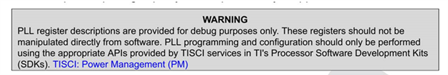

    Recommended PLL setting approach
    The DM operations will be performed by the DM core.
    Typically, these PLL settings are configured by DM core and change of PLL effects to SOC operations.
    So, mostly, we do not encourage customers to change them
    we plan on putting the following note in the TRMs
     https://e2e.ti.com/support/processors-group/processors/f/processors-forum/1464980/am62a7-max-pll-frequency/5621848
    Most of the PLLs are required to operate at a fixed preset frequency.
    I don't see a maximum frequency specified in the TRM or above in this thread.  Is the implications that we shouldn't run PLL1 faster than the default 1920MHz?  Per the TRM other PLLs run in the ~2.5GHz range, does this not apply to PLL1?
    The maximum Frequency for the PLL is 3.2GHz.

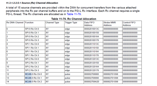

    We need to enable DMA transfers for MCSPI and MCAN.
    Q1. Is the following understanding correct?
    • MCSPI0/1/2 support both TX and RX DMA transfers with PDMA0.
    • MCAN0/1 support both TX and RX DMA transfers with PDMA0.
    Q2. Do PDMA1 and PDMA2 support DMA transfers for MCAN?
    The MCSPI and MCAN peripherals support both TX and RX DMA channels.
    However, the DMA channels for MCAN and MCSPI are statically mapped to either PDMA0, PDMA1, or PDMA2, depending on the SoC architecture.
    This means that the peripheral-to-DMA connections are fixed in hardware and cannot be reassigned from one PDMA instance to another.
    We need to continuously perform high-speed, high-volume communication (Clock: 6 MHz, Data Size: 2 KB) in SPI Slave mode within the MCU domain.
    However, when we set the MCSPI Operating Mode to "DMA Mode" in the SysConfig for the MCU domain, we receive the message: "DMA is not supported in MCU Domain."
    We were planning to use DMA for this purpose—does this mean that DMA is actually not available in the MCU domain?
    If DMA is indeed not supported, could you kindly suggest any alternative solutions to achieve our communication requirements?
    The MCU core does not support PDMA, so the MCU domain MCSPI cannot be used with DMA.
    If the customer wants to use DMA with MCSPI from the MCU core, they can access the MAIN domain MCSPI, which supports DMA .
    This allows high-speed data transfer without CPU overhead.
    However, if the customer prefers to use the MCU domain MCSPI, they must operate it in interrupt mode since DMA is not supported.

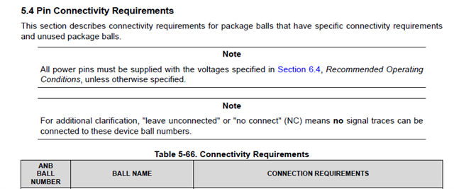

    I would like to know the behavior of the AM62A when this reserv pin is shorted to the power supply or GND. Therefore, I would like to know the electrical behavior including the rated voltage.
    Please refer inputs i received from the expert:
    The customer should never purposely connect anything to these pins or allow them to be connected anything by accident.  There characteristics of these pins are not defined because the customer should never connect anything to them.  The device may not work as expected and may be damaged if they connected to power or ground.  The customer must ensure this never happens.
    We are currently checking our products from the perspective of functional safety.
    It is necessary to know what mode it will fall into when a failure occurs, and the above information is necessary for that.
    I understand that it is a "Reserve pin", but could you please answer my question?
    Please refer below inputs i received from the device expert and design team.
    We expect customers to do whatever is necessary to ensure the reserved pins never get connected to anything.  We expect customers to do whatever is necessary to ensure the reserved pins never get connected to anything.  We did not validate the device operation for any other condition.  Therefore, so we are not able to say what will happen if they allow any of the reserved pins to connect to other pins or signals.
    The SOC may not work properly. Just like if a power pin were shorted to ground.
    They need to have some mechanism like a challenge-response watchdog external to the SOC to Protect against this.
    The safety concepts we show always have a separate monitor device that can cause the system to be in a safe state
    Regardless of what happens to the SOC.   They need to treat issues with these reserved pins like shorting to a supply rail
    As possibly causing the SOC to be completely offline / possibly damaged / and possibly shorting out the power rails connected
    To the SOC.
    The monitor needs to be independent enough to cause the safe state entry if any of those things happen.
    We cannot give more detail or guarantee behavior on reserved pins past what is documented in the datasheet.
    (+) AM625: RSVD pins - Tristated or have a potential? - Processors - INTERNAL forum - Processors - INTERNAL - TI E2E support forums
    The reserved pins are for TI use only.  They are not traditional IO pins and there are no plans to disclose their function. The customer needs to follow the datasheet recommendations, where it says to leave these pins unconnected. Leave unconnected means do not connect any PCB signal trace to these pins.
    The device could be damaged if these pins short to an adjacent ball, which is the same for any ball on the package.
    There is no action the customer can take for these pins other than do not connect any PCB trace.
    There are lots of pins on the AM62x device that would not tolerate a short to an adjacent pin. So they need to ensure this never happens.

    If you uses kernel devicetree k3-am625-sk.dts as your reference, the default frequency would be 1.4GHz, but if you use k3-am62-lp-sk.dts as the reference, the default frequency would be 1.25GHz. Because k3-am625-sk.dts has "opp-140000000" defined in the opp-table node, but k3-am62-lp-sk.dts doesn't.
    1.4GHz is only supported with 0.85V VDD_CORE.

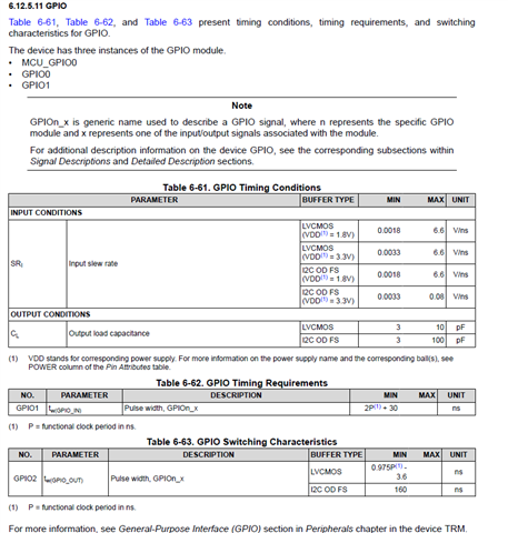

    What about GPIO? the short answer
    TI does not support both Linux and MCU+ SDK interacting with the same GPIO module. You may be able to get it to work, but we have neither tested nor validated this usecase.
    The longer answer
    1. In general, peripherals & peripheral interfaces are designed to only have one software instance controlling them. This is true for both Linux and MCU+ cores (e.g., I2C0 cannot be controlled by both DM R5F and MCU domain R5F).
    2. The exceptions to 1) are the DDR interface, the display interface (AM62Px only), and GPIO modules (where the interrupt for a single GPIO bank can still only be routed to a single software instance). GPIO sharing is only tested with MCU+ cores, NOT tested or validated with Linux & non-Linux. More about GPIO sharing between MCU+ cores at  [FAQ] AM64X/AM62X: How do I route the same GPIO bank interrupts to different destination cores?
    3. Linux requests exclusive ownership of a power domain? (PD? currently unclear how this is different from requesting the peripheral itself), while MCU+ cores do not. This means that if there is ever a resource conflict between Linux and an MCU+ core, the 2nd core to request ownership of a peripheral will throw an error (CASE 1: Linux requests first and sets exclusive access. The following MCU+ SDK request is rejected. CASE 2: The MCU+ core requests first and sets non-exclusive access. Since nonexclusive access is already set, the Linux followup request for exclusive access is rejected)
    4. If there is ever a resource conflict between MCU+ cores, the MCU+ cores will NOT throw an error (since each MCU+ core will request non-exclusive access). So they could theoretically overwrite each other's register settings. Customers are expected to statically allocate peripherals during the software design phase to avoid conflicts. For processors with system projects in SysConfig (AM243x & AM64x), the system project will warn the user of any conflicts. However, there are not currently any tools to check for resource conflicts in AM62 family devices.
    So what does that mean in practice?
    You would still want to only enable the GPIO module (and do the associated GPIO pinmuxing) in either Linux, or on the MCU+ core. Because if the same GPIO module is enabled in both places, then the 2nd software instance to request ownership of the GPIO module will throw an error.
    After a single software instance initializes the GPIO module, you could potentially configure the interrupt routing so that the other software instance could receive an interrupt from the GPIO module and take actions as needed. We would be limited in the support we could provide here, since we have not actually tried to do that between Linux & MCU+ cores.

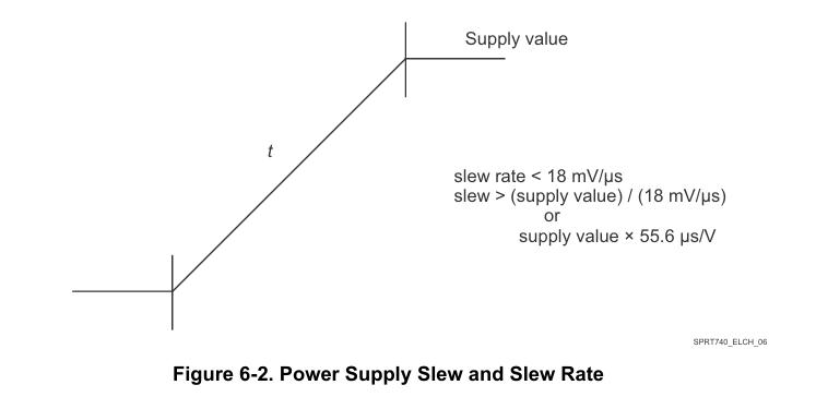

    Inputs related to delay between supply rails for processor power-up sequence
    Input 1
    The VDDS_DDR and VDDS_DDR_C power rails are expected to be powered from the same power source. This waveform shows a grey transition region that begins with the first rising edge and ends with the second rising edge. The supply that powers VDDS_DDR and VDDS_DDR_C can change anywhere in the grey transition region. So it is okay for the the 0.85V supply to ramp before the 1.2V supply.
    Note: We insert multiple transitions within the grey transition region of some waveforms when they represent a transition region for power rails which may receive power from multiple sources. Multiple transitions within the region is used to indicate these power rails can ramp anywhere within the transition region and they do not have any dependency on the other power rails associated with the waveform. Transition regions like the one used for VDDS_DDR and VDDS_DDR_C, indicate all power rails associated with the waveform are powered from a common source and are expected to ramp at the same time anywhere within the transition region.
     The shaded region of the waveform represents a range of time where a supply may ramp up/down relative to other supply rails.  The hatch marks within a shaded region is used to represent multiple power rails just in case all power rails represented by a waveform are not powered from the same source. For example, there may be a reason to power some 1.8V power rails form one source while other 1.8V rails are powered from another source.
    I will be adding legends to this section of the datasheet to describe these two types of transition regions.
    Input 2
    There is only one firm requirement for AM64x power-down. See note 5 associated with the power-down sequence.
    The potential applied to VDDR_CORE must never be greater than the potential applied to VDD_CORE + 0.18V during power-up or power-down. This requires VDD_CORE to ramp up before and ramp down after VDDR_CORE when VDD_CORE is operating at 0.75V. VDD_CORE does not have any ramp requirements beyond the one defined for VDDR_CORE. VDD_CORE and VDDR_CORE are expected to be powered by the same source so they ramp together when VDD_CORE is operating at 0.85V.
    Input 3
    Can we share the requirements of timing between the different voltage supply waveforms rising on power-up and falling on power-down. For example, how long after Waveform A rises must Waveform B wait before rising?
    There are no specific timing requirements for these sequencies. The sequence defined in the datasheet is only required to prevent voltage potential differences.
    in Figure  Power-Up Sequencing of the Datasheet, is there  requirements for the time interval of each voltage?
    * Spacing of vertically drawn dashed lines
    No.  No specific time is required between the groups as long as one has ramped before the next begins.

    AM6442: Powering AM6442BSFFHAALV with TPS6522430RAHRQ1
    The processor sequencing requirements can be found in the datasheet under "Power Supply Sequencing".
    Power Supply Sequencing I can only find the order of the rails.
    However, the delays between the different power supplies are not specified in the datasheet.
    The only delay mentioned is the one between “all supplies valid” and the MCU_PORs (9.5ms).
    Does this mean that the delays between the power supplies themselves don’t matter, and only the sequence is relevant?
    We do not specify the delay between rails. Instead, we have slew rate requirements and sequence order. A supply group must fully ramp to the targeted output voltage with the required slew rate before the next one in sequence start ramping up.

    Inputs related for overclocking
    (+) SK-AM62P-LP: Overclocking to 1.6 GHz and Thermal Solution Requirements - Processors forum - Processors - TI E2E support forums
    Please follow the OPP table in the below section of the data sheet.
    Table 6-1. Device Speed Grades
    I checked with the expert.
    We do not support operation above the limits defined in the datasheet.

  • Hi Board Designers
    Inputs related to VDD_CANUART and VDDSHV_CANUART
    VDDSHV_CANUART is recommended to be connected to an always-on power source when partial
    IO (low-power) mode is implemented. The recommendation is to connect VDDSHV_CANUART to any
    valid IO power source (1.8V or 3.3V) when partial IO (low-power) mode is not used.
    VDD_CANUART can operate at 0.75V or 0.85V, there is no voltage dependency with the VDD_CORE during
    normal operation. The only voltage dependency is during power-up and power-down sequencing.
    VDD_CANUART is recommended to be connected to an always-on power source when partial IO (low-power)
    mode is used. The recommendation is to connect VDD_CANUART to the same power source as VDD_CORE
    VDDSHV_CANUART
    (3) VDDSHV_CANUART, VDDSHV_MCU, and VDDSHVx [x=0-3] are dual voltage IO supplies which can be operated at 1.8V or 3.3V(3) VDDSHV_CANUART, VDDSHV_MCU, and VDDSHVx [x=0-3] are dual voltage IO supplies which can be operated at 1.8V or 3.3Vdepending on the application requirements.VDDSHV_CANUART shall be connected to an always-on power source when using Partial IO low power mode, or connected to anyvalid IO power source when not using Partial IO low power mode. When VDDSHV_CANUART is not connected to an always-on powersource and is operating at 3.3V, it shall be ramped up with other 3.3V supplies during the 3.3V ramp period defined by this waveform.When any of the VDDSHV_MCU and VDDSHVx [x=0-3] IO supplies are operating at 3.3V, they shall be ramped up with other 3.3Vsupplies during the 3.3V ramp period defined by this waveform.
     (5) VDDSHV_CANUART, VDDSHV_MCU, and VDDSHVx [x=0-3] are dual voltage IO supplies which can be operated at 1.8V or 3.3V
    source and is operating at 1.8V, it shall be ramped up with other 1.8V supplies during the 1.8V ramp period defined by this waveform.
    When any of the VDDSHV_MCU and VDDSHVx [x=0-3] IO supplies are operating at 1.8V, they shall be ramped up with other 1.8V
     VDD_CANUART
    (9) VDD_CANUART shall be connected to an always-on power source when using Partial IO low power mode.
    When VDD_CANUART is connected to an always-on power source, the potential applied to VDD_CORE must never be greater than
    the potential applied to VDD_CANUART + 0.18V during power-up or power-down. This requires VDD_CANUART to ramp up before
    and ramp down after VDD_CORE. VDD_CANUART does not have any ramp requirements beyond the one defined for VDD_CORE.
    (10) VDD_CANUART shall be connected to the same power source as VDD_CORE, VDDA_CORE_CSI_DSI, VDDA_CORE_DSI_CLK,
    VDDA_CORE_USB, and VDDA_DDR_PLL0 when not using Partial IO low power mode.
    VDD_CANUART, VDD_CORE, VDDA_CORE_CSI_DSI, VDDA_CORE_DSI_CLK, VDDA_CORE_USB, and VDDA_DDR_PLL0 can
    be operated at 0.75V or 0.85V. When these supplies are operating at 0.75V, they shall be ramped up prior to VDDR_CORE as defined
    by this waveform.
    (11) VDD_CANUART shall be connected to the same power source as VDD_CORE, VDDA_CORE_CSI_DSI, VDDA_CORE_DSI_CLK,
    be operated at 0.75V or 0.85V. When these supplies are operating at 0.85V, they shall be powered from the same source as
    VDDR_CORE and ramped during the 0.85V ramp period defined by this waveform.
    Partial IO"  is the low power mode that requires supplying the CANUART rails (VDD_CANUART, VDDSHV_CANUART) with always-ON discrete devices. "Partial IO" is the only AM620-Q1 low power mode that requires turning-OFF external regulators. To get the lowest power consumption when supporting "Partial IO" LPM, the PMIC_LPM_EN0 drives the PMIC enable pin low which triggers an OFF request. Two external discrete LDOs are kept ON to supply the CANUART rails. For "Partial IO" low power mode, VDDSHV_CANUART and VDD_CANUART are the two rails that must stay ON.  Partial IO power consumption is in the uW (<1mW).

    Inputs related to interrupt edge slew and pulse duration - Recent customer query resolved
    AM2754-Q1: Falling edge interrupt spec.
    I am studying the AM275 GPIO interrupt detection capability, specifically for falling-edge triggered interrupts. However, I could not find any relevant timing requirements in the TRM or datasheet.
    For AM275 GPIO inputs, is there a minimum low-level pulse width requirement for detecting a falling-edge interrupt?
    For example, if a GPIO signal transitions from High to Low and remains Low for approximately 100 ns before returning High, can this pulse reliably trigger a falling-edge interrupt? Or is there a possibility that such a short pulse could be filtered out or missed by the SoC?
    Please refer to the electrical characteristics below
    I added the links below that you can refer for different IO buffers.
    https://www.ti.com/lit/ds/symlink/am2754-q1.pdf#page=63

    Please refer to the notes at the end of electrical characterisitics.
    If the interrupt follows the GPIO specification, the processor is expected to detect the interrupt.
    We understand your point that as long as the interrupt behavior follows the GPIO specification, the processor is expected to detect the interrupt, and that only edge-triggered interrupts are supported.
    However, to clarify our original question, we are specifically trying to understand the minimum timing requirement for reliable edge detection. From our perspective, after a falling edge occurs, the signal typically needs to remain at low level for a certain minimum duration to ensure that the edge can be effectively detected by the processor.
    In this regard, we are essentially asking whether there is a defined minimum low pulse width (or equivalent timing parameter) in the GPIO specification that guarantees reliable detection of the falling-edge interrupt.
    It seems this aspect may not have been explicitly addressed yet, so we would greatly appreciate it if you could help confirm or point us to the relevant specification or documentation.
    Please refer below for
    AM275
    AM62P
    Note: The GPIO supports only edge interrupt
    The document you provided is exactly what I was looking for. I have also found the relevant specification in the latest datasheet.
    Although the interrupt behavior is not explicitly mentioned, I assume the related specifications should already be covered there in the capture that you have supplied.

    AM644x, AM243x, AM62L VDDA_3P3_SDIO (internal LDO input connection) and supply ramp
    The VDDA_3P3_SDIO connects to the SD card power switch output.
    I assume VDDA_3P3_SDIO is treated as a supply rail and the slew rate requirements for the other supply rails is applicable for the VDDA_3P3_SDIO supply input.
    Any thoughts please.
    Yes.  The ramp limit is associated with the ESD circuit implemented on each power rail, so the same limit applies to all power rails.
    Sreenivasa
  • Hi Board designers,
    FYI on supply slew and internal ESD
    (+) AM6548: Confirmation on slew rate - Processors forum - Processors - TI E2E support forums
    Per the datasheet for the AM6548, the maximum slew rate is recommended to be less than 100 mV/µs for supplies in general, and less than 40 mV/µs for the VDDA_1P8_SERDES0 supplies. Alternatively, the slew time must be greater than the supply value x 10µs, and greater than supply value x 25µs, respectively.
    Just to confirm, this slew rate does apply for both rise and fall times?
    The max power supply slew rates requirement defined in the datasheet only applies when the power rails are ramping up. The ESD circuits implemented on the power rails may false trigger, clamping the power rails to VSS if the power rails ramp too fast.
    Are there any requirements on the slew rate for fall times?
    No.
    Additional inputs:
    The power supply slew rate is only defined for power-up. This slew rate limit is required to prevent the ESD circuits implemented on the power pins from accidently triggering.
    We expect MCU_PORz to be applied before any of the supplies begin to drop.  MCU_PORz signal not reaching a valid logic low level before the supplies begin to ramp down may allow unexpected things to happen on peripheral pins as power supplies decay.
    6.12.2.1 Power Supply Slew Rate Requirement, we specified to secure slew rate<18mV/us as minimum value. Do we also have maximum slew rate? My customer have troubled about these min/Max slew rate for other SoC in before.
    The maximum slew rate of 18mV/us is defined in the datasheet snapshot you inserted above. We do not define a minimum slew rate for power rails.

       1. Restriction on test mode (*Yes: O, No:X (If "Yes'', show "the condition to avoid entering any Test Mode''.
       2. Restriction on power-up sequence (*Yes: O, No:X (Does it hang up by the particular power-up sequence concerned with rising time or voltage waveform (monotone increase etc.)?
       3. Restriction on power-supply voltage (*Yes: O, No: X (Is there any restriction concerning the sudden change of the voltage even in the range of the guaranteed voltage?
       4. Restriction on ''NC'' pins (*Yes: O, No: X (To be grounded, Not to be connected etc) Another file can be used)
    1. The EMU[1:0] inputs are used to place the device in special test modes.  These inputs must be held in a valid high logic state on the rising edge of MCU_PORz and the rising edge of TRSTn to ensure the device doesn’t enter these test modes.  See the Debug Boot Modes and Boundary Scan Compliance section in the device Technical Reference Manual (TRM).
    2. Power supply sequencing is expected for proper operation and the requirements for both power-up and power-down are defined in the Power Supply Requirements.
    3. Power supply voltage requirements are defined in the Recommended Operating Conditions table.
    4. Yes, reserved pins are expected to be left unconnected.  See the Reserved Signal Descriptions table and the Pin Connectivity Requirements.
