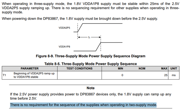

  • Hi Board designers
    Information related to
    DP83867
    www.ti.com/.../snls484
    Figure 8-7. Two Supply Configuration
    Figure 8-8. Three Supply Configuration
    Figure 8-9. Three-Supply Mode Power Supply Sequence Diagram
    Table 8-5. Three-Supply Mode Power Supply Sequence
    Figure 8-2. Magnetics Connection

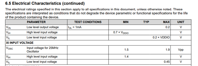

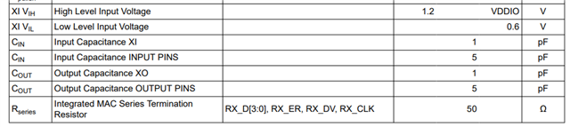

    DP83TG721S-Q1: Voltage level XI-pin Ethernet PHYs (DP83TC812S-Q1, DP83TC817S-Q1, DP83TG721S-Q1, DP83TG727S-Q1)
    What are the requirements for the XI pin for the TI Ethernet PHYs DP83TC812S-Q1, DP83TC817S-Q1, DP83TG721S-Q1 and DP83TG727S-Q1 regarding the voltage level or the VIH and VIL levels when using a clock oscillator?
    The specific question is whether a 1.8V level clock signal can be used for all of these devices also when VDDIO is 3.3V?
    Schematic Checklist/Data Sheet Extract:
    For 812S I find in the data sheet that XI VIH needs to be between 1.3V and VDDIO, where 1.8V would work (6.8, page 20) Can you confirm it's the same for the above mentioned devices as well?
    Yes, this is also the same for the other devices you mentioned.  You can use 1.8V CMOS clock.

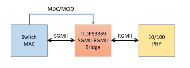

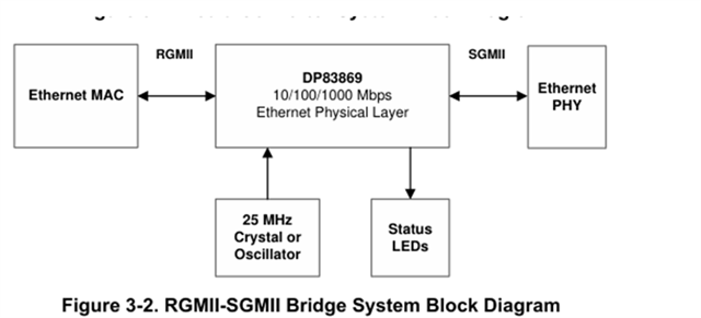

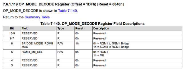

    Can we say that the customer can use the DP83869HM PHY or similar (automotive class) PHY Transceiver that supports bridge function:
    to convert from the AM620-Q1's RGMII MAC to a SGMII interface. Is this RGMII to SGMII bridge function same than the Media convertor mode ?
    The DP83869HM datasheet indicates it is able to function as a RGMII to SGMII bridge, which would allow an SGMII PHY to be connected to one of the AM62x RGMII ports via the DP83869HM bridge.  This should be fairly straight forward from a hardware perspective, but it may require some custom software support.  At a minimum, software would need to configure the DP83869HM bridge and the SGMII PHY via MDIO.  I’m not sure what would be required for software to support this bridge function, but I suspect it is also fairly straight forward.  It may be as simple as configuring the DP83869HM bridge and the SGMII PHY during initialization and everything works as expected after that, without any further software intervention.
    The media conversion function supported by DP83869HM appears to be different than the bridge function.  From my understanding the media conversion function is a standalone function that is inserted between a fiber media and a wire media.  For this function, a MAC is not required on either end of the conversion.
    https://www.ti.com/tool/TIDA-00306
     The bridge function supported by DP83869HM converts a RGMII MAC interface to an SGMII interface or a SGMII MAC interface to an RGMII interface, where one end is connected to a MAC and the other end is connected to a PHY.
    Can you review if we can use DP83869HM in this way? thanks!

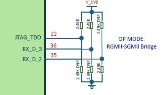

     DP83869 could be used in this application.
    SFP module:
    Media Converter Mode can be configured via the jumpers (OPMODE 100) and no software configuration is needed!
    If the customer wants to use software to enable it, please see Section 7.4.8.5 1000M Media Convertor Mode .

     DP83869HM: SGMII-RGMII Bridge Mode Strapping
    https://www.ti.com/lit/an/snla318/snla318.pdf
    I tested this in the lab on the DP83869EVM. I'm seeing RGMII to SGMII bridge mode with Pin 38 pulled up. When the pullup is removed, the op-mode is SGMII to RGMII.
    I used register 0x01DF to determine the mode of operation. With the pullup present, this register was 0x0003. With the pullup removed the register is 0x0043:
    The datasheet is correct here. I'll look at getting that app note SNLA318 updated in the future.
     DP83869HM: DP83869HM SGMII-to-RGMII Bridge mode application question
    You can use the DP83869 bridge mode, please see this app note on the different mode of operation.
    There is also a reference design showing the RGMII connection between AST2600 and DP83869.
    For the two bridge mode, it depends on which MAC interface you want to select the operating speed of in bridge mode. In RGMII-to-SGMII bridge mode, the RGMII side automatically adjusts to the link-up speed on the SGMII side. In SGMII-to-RGMII bridge mode, SGMII adapts the link speed based on RGMII.
    (5) [FAQ] DP83869HM: DP83869 in Bridge Mode to connect two MACs - Interface forum - Interface - TI E2E support forums

     RE: DP83869HM: 1DFh register, RGMII-to-SGMII bridge mode

     DP83869HM: RGMII to SGMII bridge auto negotiation not succeeding
    Smart Bits (data generator) <-Ethernet Cable (1000Mbps)-> DP83867SEVM <-SGMII-> DP83869HMEVM -> Oscilloscope probing the RX_CLK signal.
    When Reg 0x1DF = 0x0043, the RX_CLK freq was 125 MHz (the expected value). You are correct, Reg 0x43 functions as RGMII-to-SGMII bridge.
     AM6442: Linux driver for Ethernet PHY DP83869HM cannot set OP_MODE to the RGMII-to-SGMII Bridge mode
    I understand that using the command is just setting the device in SGMII-RGMII mode.
    The driver is a sample model of the driver and should be tweaked by customer as per their use case.
    Can you please ask customer to tweak the driver to set the OP_MODE_DECODE register to 0x003 instead of 0x0043?
    Customer can also choose to use hardware straps to set the mode correctly.

     DP83869HM: interface between our RGMII and the user's SGMII link?
    We have a need to interface with user equipment's SGMII (dual ports).
    The processor that we are using only has dual port RGMII.
    Can I use the DP83869HMRGZT to facilitate the interface between our RGMII and the user's SGMII link?
    Does Ti have a dual port RGMII to SGMII part?
    Below is the drawing of the interface.
    Can we use the DP83869 for this interface?
    DP83869 can help via bridge mode, but it will be extremely important that there is speed uniformity across the signal chain. RGMII can determine speeds via RX_CLK, while SGMII has auto-negotiation.
    Actually, my requirement was to configure PHY in "RGMII to SGMII bridge mode" and I was supposed to use below mentioned strapping.
