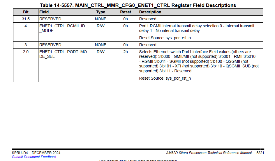

10.Are the above series resistor recommendations valid for MII or RMII interface
11.Is there any clock recommendations When using Ethernet interface
12.Recommendations for using External clock oscillator
13.IO levels supported for Ethernet interface
14.Is the RGMII internal delay supported by the processor and is the RGMII internal delay configurable
