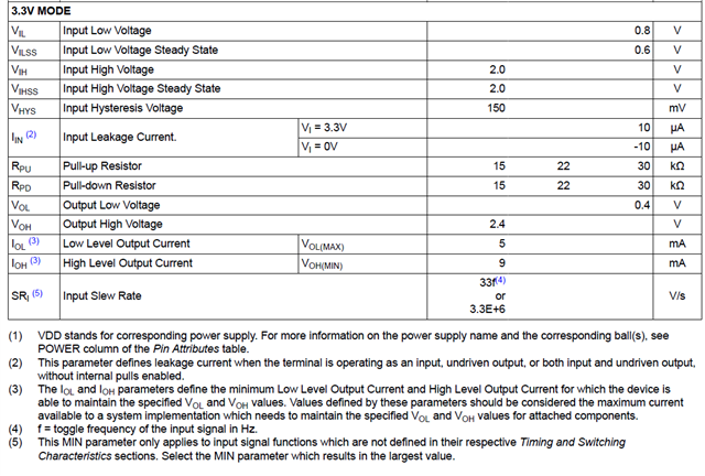

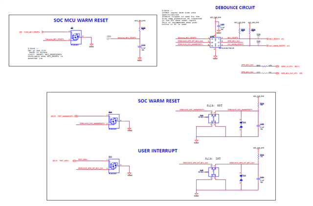

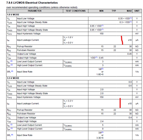

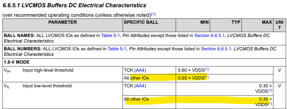

Hi TI Experts,

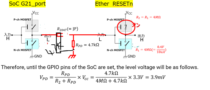

Do you have recommendations on using the GPIOs - Configuration, Slew rate, Current drive, Buffer type, and interfacing to external signals
Note:

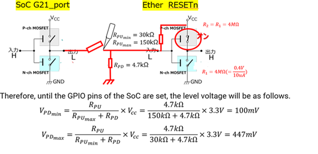

Pull value for LVCMOS, SDIO,  eMMC for AM64x, AM62Px implement Hard Macro ePHY (dedicated function)
 AM6442: GPIO Behavior on TMDS64EVM When Connected to GND or VCC and supported pulls
Unused iOs connection

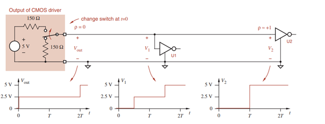

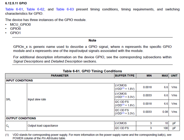

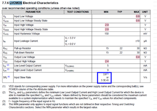

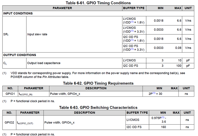

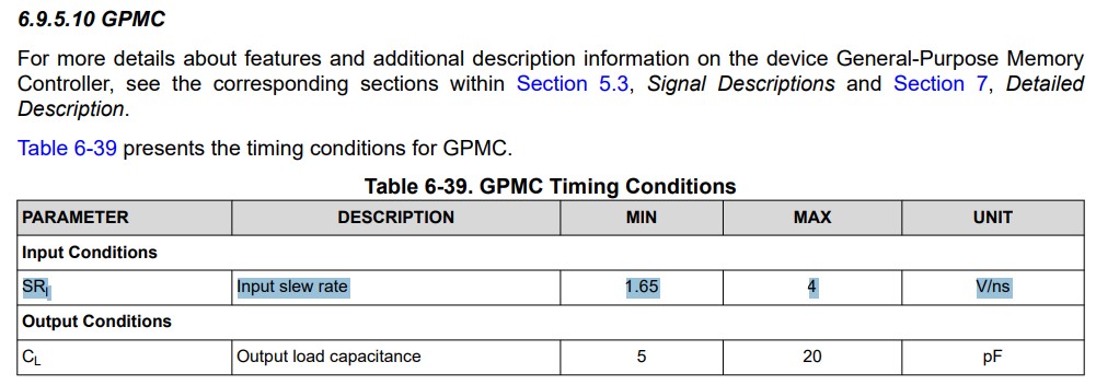

IO slew
 RE: AM620-Q1: Input Slew Rate
 RE: AM6442: Sigma Delta Interface Slew Rate
 [FAQ] AM623: RGMII Input Slew Rate for CPSW3G

  • Hi Board Designers,
    Refer below inputs:

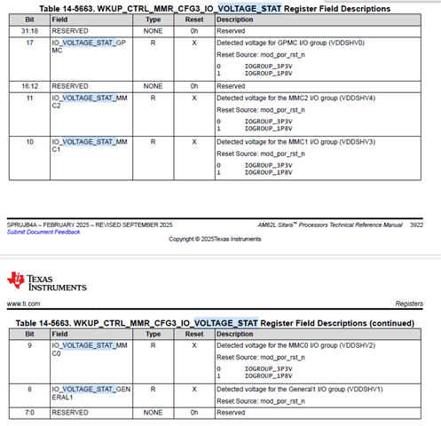

    AM62L
    Supported IO supply for IO groups are listed below:
    • VDDSHV0 – Dual-voltage IO supply for GPMC0 IO group (Fixed), DPI, bootmode, GPMC0
    • VDDSHV1 – Dual-voltage IO supply for General interface IO group (Fixed)
    • VDDSHV2 – Dual-voltage IO supply for MMC0 IO group (Fixed or Dynamic supply switching)
    • VDDSHV3 – Dual-voltage IO supply for MMC1 IO group (Fixed or Dynamic supply switching)
    • VDDSHV4 – Dual-voltage IO supply for MMC2 IO group (Fixed or Dynamic supply switching)
    VDDS0 – Fixed-voltage supply for GENERAL0 IO group (RGMII1, RGMII2 IO groups)
    VDDS1 – Fixed-voltage supply for GENERAL0_1 IO group (includes OSPI0 IO group)
    VDDS_RTC – Fixed-voltage supply for LFOSC0 and RTC IO group
    VDDS_WKUP – Fixed-voltage supply for WKUP IO group

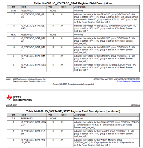

    AM62x
    • VDDSHV0 – Dual-voltage IO supply for Main reset and General interface IO group (Fixed)
    • VDDSHV1 – Dual-voltage IO supply for OSPI0 IO group (Fixed)
    • VDDSHV2 – Dual-voltage IO supply for RGMII1, RGMII2 IO group (Fixed)
    • VDDSHV3 – Dual-voltage IO supply for GPMC0 IO group (Fixed), DPI, bootmode, trace
    • VDDSHV4 – Dual-voltage IO supply for MMC0 IO group (Fixed or Dynamic supply switching)
    • VDDSHV5 – Dual-voltage IO supply for MMC1 IO group (Fixed or Dynamic supply switching)
    • VDDSHV6 – Dual-voltage IO supply for MMC2 IO group (Fixed or Dynamic supply switching)
    • VDDSHV_MCU – Dual-voltage IO supply for WKUP_MCU IO group (Fixed)
    • VDDSHV_CANUART – Dual-voltage IO supply for CANUART IO group (Fixed)

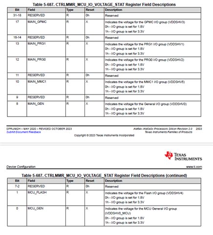

    AM64x
    • VDDSHV1 – Dual-voltage IO supply for CPSW3G, PRG0 IO group (Fixed)
    • VDDSHV2 – Dual-voltage IO supply for PRG1 IO group (Fixed)
    • VDDSHV4 – Dual-voltage IO supply for OSPI0 IO group (Fixed)
    • VDDSHV_MCU – Dual-voltage IO supply for MCU General IO group (Fixed)

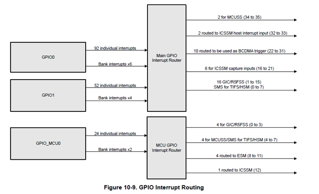

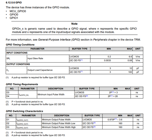

    Available GPIO instances and interrupt  capability
    GPIO Use Cases and Implementation With the AM6x Family of SitaraTm MPU Devices
    https://www.ti.com/lit/ab/spradk0/spradk0.pdf
    AM64x/AM243x
    Signal Descriptions
    GPIO
    MAIN Domain Instances
    GPIO0 Signal Descriptions
    GPIO0_0 ... GPIO0_86
    GPIO1 Signal Descriptions
    GPIO1_0...GPIO1_79
    MCU Domain Instances
    MCU_GPIO0 Signal Descriptions
    MCU_GPIO0_0...MCU_GPIO0_22
    General Purpose Input/Output Interface (GPIO)
    Integrated in MAIN domain: Two General Purpose Input/Output (GPIO) modules that provide dedicated general purpose
    pins that can be configured as either inputs or outputs. The GPIO modules main features include:
    • Support of 9 banks x 16 GPIO pins
    • Support of up to 9 banks of interrupt capable GPIOs
    • Interrupts can be triggered by rising and/or falling edge, specified for each interrupt capable GPIO pin
    • Set/clear functionality per individual GPIO pin
    Note:
    1. GPIOMUX_INTRTR_IN_[198:0] - Any of the 0-198 GPIOs can be routed to GPIOMUX_INTRTR0
    2. GPIOMUX_INTRTR0 supports MAIN_GPIOMUX_INTROUTER0_OUTP_[53:0] outputs
    3. MAIN_GPIOMUX_INTROUTER0_OUTP_[53:0] is split as MAIN_GPIOMUX_INTROUTER0_OUTP_[15:0] and  routed to R5FSS0_CORE0/1
    Similarly interrupts are routed to different cores and PRU

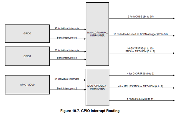

    References for interrupt

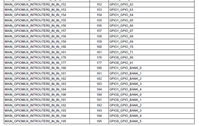

    4.7 General Connectivity
    4.7.1 General Purpose Input/Output (GPIO)
    This section contains the integration details for the GPIO modules on this device. For Further information, see
    the General Purpose Interface section of the Peripherals chapter
    10.1.5 GPIO Interrupt Handling
    There are three GPIO modules in the device, which could generate almost 200 interrupts. Those GPIO interrupt
    outputs are routed to the GPIO interrupt router first before they are routed to the final interrupt destination. The
    GPIO interrupt router allows each output to select each GPIO interrupt independently.
    Table 10-9. GPIO_mux_introuter Connection
    Bank and individual registers
    12.2.1 General-Purpose Interface (GPIO)
    This chapter describes the General-Purpose Input/Output (GPIO) for the device.
    12.2.1.1 GPIO Overview
    The General-Purpose Input/Output (GPIO) peripheral provides dedicated general-purpose pins that can be
    configured as either inputs or outputs. When configured as an output, the user can write to an internal register to
    control the state driven on the output pin. When configured as an input, user can obtain the state of the input by
    reading the state of an internal register.
    In addition, the GPIO peripheral can produce host CPU interrupts and DMA synchronization events in different
    interrupt/event generation modes.
    The device has one or more instances of GPIO modules. The GPIO pins are grouped into banks (16 pins
    per bank and 9 banks per module), which means that each GPIO module provides up to 144 dedicated
    general-purpose pins with input and output capabilities; thus, the general-purpose interface supports up to 432
    (3 instances × (9 banks × 16 pins)) pins. Since MCU_GPIO0_[23:143], GPIO0_[87:143], and GPIO1_[88:143]
    are reserved in this device, general purpose interface supports up to 198 pins.
    Signal Descriptions
    12.2.1.4.4 GPIO Interrupt Connectivity
    Because this device muxes GPIO signals with other functional signals, the availability of any particular GPIO and
    hence the usability of its associated interrupt will change based on the use case pin muxing. The large number
    of possible GPIO interrupt sources makes it impractical to route all interrupt events to each processing element.
    Since most applications do not typically require a large number of GPIO interrupts, the interrupt uncertainty
    is resolved by mapping all GPIO interrupts to a series of event muxes implemented using Interrupt Router
    (IntRouter) modules. These muxes allow any one of the available GPIO interrupts to be selected and passed
    on as an event to the various processor interrupt controllers and DMA controllers. Event selection is controlled
    through associated registers within each IntRouter.
    The GPIO bank interrupts already represent a consolidation of the 16 GPIO interrupts associated with each bank
    and are routed directly to various interrupt controllers rather than through the GPIO IntRouters.
    One of the GPIO pins has a potential use case as an Arm reset input and should therefore be routed as highest
    priority interrupt in the GIC and mapped to nFIQ in software.

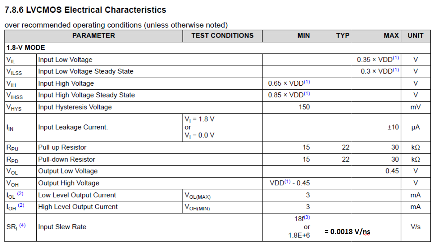

    LVCMOS VIH/VIL
    The datasheet states output voltage level of LVCMOS as follows.
     1.8V mode:
    VOL     0.45V max.                 @ IOL=3mA
    VOH     VDD-0.45V min.          @ IOH=3mA
    3.3V mode:
    VOL     0.4V max.                   @ IOL=5mA
    VOH     2.4V min.                   @ IOH=9mA
    AM62P LVCMOS connects to a CMOS buffer fewer current ,e.g. 100uA, would be expected, in general.
    Is there any definition by small current available in order to have lower VOL and higher VOH ?
    If yes, it might contribute to flexible device selection.
    Answers
    We recommend customer to use the IBIS model and perform simulation for any current lower than the data sheet recommended value to derive the voltage level.
    The customer will need to use the IBIS model of the output buffer in a simulation with the reduced load to determine the VOL and VOH values for their operating condition.
    What I am asking is if TI can provide guaranteed VOL and VOH with lower current than datasheet value.
    There are no plans to provide any other data points in the datasheet. It is not possible for TI to know the DC load applied to each output buffer of every customer's AM62Px system design. Therefore, we only define the minimum Low Level Output Current and High Level Output Current for which the device is able to maintain the specified VOL and VOH values.
    (+) [FAQ] AM6442: AM6442 LVCMOS Buffer Type - Processors forum - Processors - TI E2E support forums
    The Electrical Characteristics tables defines capabilities of a specific IO cell. It does not define a how the IO is configured to operate. You need to reference the Pin Attributes table to understand how the IO associated with each pin is configured to operate. For example, the AM64x RESETSTATz signal function is implemented such that it is "Off / Low / Off" while MCU_PORz is asserted and "Off / SS / Off" after MCU_PORz has been de-asserted. This indicates the input buffer associated with the RESETSTATz pin is turned off during and after reset. The output buffer associated with the RESETSTATz pin is enabled during and after reset, where the output is actively driven low during reset and controlled by the reset subsystem after reset. The internal pull resistors associated with the RESETSTATz pin are turned off during and after reset.
    In summary the RESETSTATz pin is an always enabled output only pin, where Vol, Voh, Iol, and Ioh are the only parameters defined in the LVCMOS Electrical Characteristics table that applies to the LVCMOS IO that is being used to implement the RESETSTATz pin.
    AM62P pin status during reset

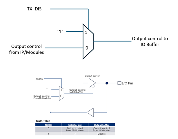

    Unused pin Default State
    The default configuration disables both the receiver and the transmitter in the IO
    The input buffer is turned off, the output buffer is disabled, and internal pulls are turned off for most of the device pins by default. This is done because most of these pins have multiple signal functions, and we never know how they are going to be used. The ESD circuits are still attached to the pin, but our ESD circuits are only design to protect the device before and during PCB assembly. ESD performance is only based on human body models and charged device models that represent a typical person or machine handling the device when it is being installed on the PCB. The ESD circuits were not designed to protect the pins from system level ESD events after being installed on the PCB.  Your system design must protect the device pins from any Electrical Over-Stress (EOS) event after it has been installed on the PCB.  Connecting unterminated signal traces to these pins would not be a good design practice since there is nothing to limit the voltage potential of these pins.

    Specification of output voltage of LVCMOS
    The customer is trying to use the LVCMOS output pin with 1.8VMODE, but the maximum vol value is 0.45V (IOL = 3mA), which is a high specified value, and the design does not work if the electrical characteristics are interpreted as it is.
    Assuming that vol is specified by the on resistance of the NMOS of LVCMOS, is it correct to assume that if an external PD is prepared, the IOL is 0 mA, so the actual vol is 0 V (because the voltage drop at the on resistance of the NMOS does not occur)?
    The max limit defined for VOL is valid as long as the IOL is less than 3mA, and the min limit defined for VIH is valid as long as the IOH is less than 3mA.
    The datasheet is saying the output buffer is able to sink current up to the min IOL current of 3mA and the low-level output voltage will remain less than the max value of 0.45V defined for VOL, and the output buffer is able to source current up to the min IOH current of 3mA and the high-level output voltage will remain greater than the min value of (VDD - 0.45V) defined for VOH.
     https://e2e.ti.com/support/processors-group/processors/f/processors-forum/1534012/am6422-connecting-unused-processor-ios-or-power-pins-or-nc-pins
    AM6422: Connecting unused processor IOs or power pins or NC pins
    How does a circuit act as a LVCMOS buffer?
    If an external PD resistor or input buffer is connected and the low-side FET is turned on while AM64 is output low, will the current not drive?
    The output buffer will source current from the respective VDD IO power rail to the external connections when driven high, or sink current from the external connections to VSS when driven low. The signal voltage will depend on the source current or sink current. The only data point we define in the datasheet is for current up to 3mA, where the signal voltage will remain less than the max VOL value of 0.45V as long as the sink current is less than 3mA, and the signal voltage will remain greater than the min VOH value of (VDD - 0.45V) as long as the source current is less than 3mA. The internal voltage dropped across the output buffer will decrease as the current decreases. A typical LVCMOS input buffer only has a few uA of input leakage current that needs to be driven by the output buffer to hold a valid logic state. There is a good chance external pulls, internal pulls, or combinations of external and internal pulls will present a much larger load than all attached input buffers.
    We provide an IBIS model of the output buffer that can be used to determine the resulting signal voltage for operating conditions not defined in the datasheet.
    You will need to create a simulation environment that represents your specific implementation and use the IBIS files of each device to determine the steady-state signal voltage for your specific system implementation if you are connecting a device that requires a logic high signal voltage that is greater than the min VOH value of (VDD - 0.45V) or a logic low signal voltage that is less than the max VOL value of 0.45V.

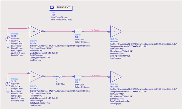

    Effect of series resistor on the LVCMOS IO output rise time
    For LVCMOS it is 10% to 90%
    (8) AM623: How to evaluate damping resistor for MMC0_CLK pin? - Processors forum - Processors - TI E2E support forums
    the best way to quickly get an idea of the right damping resistor value would probably be to run IBIS simulations. These can be run both for a singular IO such as CLK and also at the system level with all IO's (CLK, CMD, DATA). Depending on the level of accuracy you are looking for, there are multiple ways to configure your simulation setup. Replacing ideal transmission line models with actual board S-parameters that were extracted with an electromagnetic solver will result in more accuracy. Additionally, you can use an actual flash IBIS model instead of lumped elements to model the receiving device. Below, I have created a simple setup to illustrate the idea.

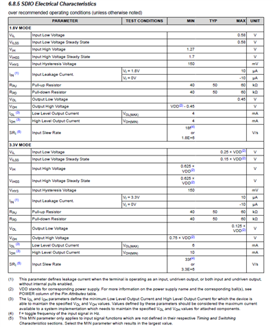

    About VILSS and VIHSS
    The VIL and VIH parameters are the traditional DC logic level thresholds, where the logic state will be low when the applied voltage less than or equal to VIL, high when greater than or equal to VIH, and undefined when greater then VIL and less than VIH.
    The VILSS and VIHSS parameters are associated with device reliability, where any steady-state potential needs to remain below VILSS or above VIHSS to minimize the input buffers shoot-through current. The input buffer has a limited amount of time it can spend in the voltage region between VILSS and VIHSS without long-term reliability concerns. This is why the Electrical Characteristics tables define a minimum slew rate parameter that constrains the amount of time an input is allowed to be in this region. The amount of time a signal can be within this region is a function of toggle frequency, with a maximum upper bound of 1000ns for rise/fall times.
    There is VIH Steady State, and a VIH (standard). What does this imply?
    The standard VIL/VIH levels represent the voltage levels which are considered valid logic levels for the input buffer. The VILSS/VIHSS levels are the steady-state voltage levels which ensue the input buffer's shoot-through current is low enough not to cause any long-term reliability concerns. Therefore, it is important for your system to be designed such that it applies a voltage less than VILSS or greater than VIHSS when the signal is held in a steady-state condition.

    Slew Rate
    The min slew rate defined in the electrical characteristics defines the max transition time allowed for the signal sourcing the input buffer to prevent any long-term reliability concern which can occur if the applied voltage spends too much time in the mid -supply region defined by VILSS and VIHSS.
    There can be long-term reliability issues associate with the input buffer if the applied signal spends too much time in the voltage region between VIHSS and VILSS. The maximum transition time allowed is 1000ns. I recommend driving the reset input with a push-pull buffer that produces a signal transition rate that is faster than 5ns to eliminate the risk of noise coupling into the signal as it transitions through the input buffer switching threshold.
    We basically need to limit the amount of time the input buffer is exposed to a mid-supply potential. The concern is related to effect on the processor internal logic implementation functioning (reliability concern) in the input buffer caused by shoot-through current that flows from VDD through the input buffer to VSS as the signal transitions through the mid-supply region. The slew rate limits ensure the device is not exposed to this condition for too long over the life of the product.
    The risk associated with violating the limit is the possibility of the input buffer failing before the device POH limit.
     There is no maximum input slew rate for the "LVCMOS" buffer when operating at either voltage, so you do not need an RC to slow the signal slew rate. You only need to be concerned with the minimum input slew rate limits defined in the "LVCMOS" Electrical Characteristics table.
    The slew rates defined in the Electrical Characteristic sections are a function of long-term reliability, where these parameter values limit the amount of time the input buffer is exposed to a mid-supply potential over the lifetime of the device.  The input slew rates defined in the respective Timing Conditions table are a function of peripheral timing closure, where we only define values required to support the max operating frequency.  It is not possible for TI to define input slew rate values for every possible operating frequency, so we expect the input slew rates to compliant to the limits defined in the Timing Conditions Table for all operating frequencies.
     The input slew rate limits associated with the GPIO signal function will be relaxed in the next revision of the AM62x datasheet.  The new values are shown in the snapshot inserted below.

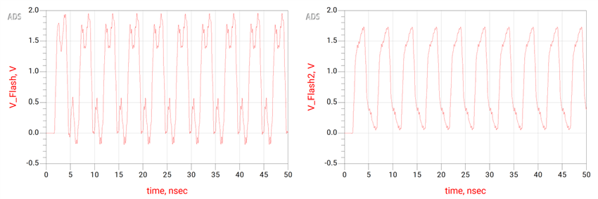

    Clock Measurement
    I suspect some of their issue is potentially measurement error being introduced by not measuring the input slew rate at the far end of the signal trace.  An LVCMOS signal will have a mid-supply step that occurs any point along the signal trace other than the far end.  This step will add time to a slew rate measurement when measured at any point along the signal path other than the far end.  For example, measuring the slew rate on a signal by placing the probe one inch from the far end of the signal trace will add about 330pf of error to your slew rate measurement.  We need to make sure the slew rate measurements are being taken at the far end of the signal trace, or make adjustments to the measured data to account for the error introduced by the mid-line signal distortion.
    Rise/Fall time measurements will typically have an additional 330ps of rise/fall time per inch from where the probe is placed relative to the far end of the signal trace.  You may be able to subtract this additional rise/fall time from your measurements if you know where the probe was place relative to the far end of the signal trace.  If so, this will allow you to determine the actual slew rate that occurs at the far end of the signal trace.
    I have inserted a snapshot that shows three signal waveforms, where the one on the left represents the signal shape at the source, the one in the middle represents the signal shape at the middle of the PCB trace, and the one on the right represents the signal shape at the far end of the signal trace.  Note: The PCB trace shown in this snapshot has an AC characteristic impedance that is equal to the output buffer source impedance and a propagation delay of T.  The same mid-supply voltage step occurs when your PCB trace has a AC characteristic impedance of 50 ohms and the output buffer source impedance of about 50 ohms.
    The duration of the mid-supply voltage step will be two times the PCB trace delay at the source.  This is how long it takes for the initial mid-supply transition to propagate to the far end of the PCB trace and reflect back to the source.
     The duration of the mid-supply voltage step will be equal to the PCB trace delay at the middle of the PCB trace.
     There is no mid-supply voltage step at far end of the signal trace.
    This mid-supply voltage step stretches the rise/fall time measured by the duration of the mid-supply step, which is a function of where the probe is placed along the PCB trace.  The duration of the mid-supply step measured by probing somewhere in the middle of the signal trace will be the time it takes for the signal to reach the far end of the signal trace after it passes the probe point plus the time it takes for the reflection to return from the far end of the signal trace back to the probe point.  The typical propagation delay of most PCB signal traces is about 167ps/inch.  This is why my 1 inch example mention in the previous reply would have a mid-supply step duration of about two times 167ps.  For this example, you would need to subtract about 334ps from the measured rise/fall time to get a better understanding of what the actual slew rate would be at the far end of the PCB trace.

    Q1: Regarding Input signal rise time and Input signal fall time in the datasheet "5.12.17.1 MMC Electrical Data and Timing",
    is it necessary to strictly observe the MIN value of 1ns?
    A1. The input rise/fall times defined in the Timing Conditions table were used as the input signal limits when the MMC peripheral was timing closed to meet all Timing Requirements and Switching Characteristics defined within this section of the datasheet.  Your customer is expected to perform a timing analysis of their system implementation, where they consider the timing requirements of each device when taking into consideration the combination of PCB delays and switching characteristics of the sourcing device. They should not have a problem with a faster rise/fall time if their system has more than enough margin to account for the difference between the actual min rise/fall time and the min rise/fall time listed in the Timing Conditions table.
    Where was the customer probing the DAT3 signal when measuring the rise time shown in the attached waveforms?  I ask because the rise/fall time is different based on where you place the probe along the transmission line. They need to be probing at the AM437x pin. I would also like to know how they were sure these waveforms properly represent the signal rise time when being driven by the eMMC device rather than driven by AM437x.
    Q2. I checked the following thread. is the rise time specified from 10% to 90% instead of VILmax to VIHmin?
    A2. I think the other thread is correct. Our timing closure team most likely used 10% to 90% instead of VILmax to VIHmin.
    The rise/fall shape is typically distorted at the near-end, where it will have a discontinuity at approximately mid-supply. I was almost certain the signal being measured was being probed near the far-end of the transmission line based on the rise/fall shape. However, I wasn't sure where they were probing the signal. Looking at the data transition delay relative to clock is another good way to confirm the transition capture was the result of the eMMC sourcing. Based on the above information, we are now certain the rise/fall being measure is the AM335x data input signal.
     My previous comment was based on the approach we use today. I suspect the process has not changed since all of our IO timing models are based on 10/90 voltage limits. When performing timing closure of a peripheral, we convert any rise/fall time requirements of industry standards/specifications to a slew rate using the specified voltage limits then apply the slew rate to our 10/90 limits. This effectively scales the rise/fall times requirements from industry standards to match our model.
    I'm glad to see your customer is being very diligent in confirming there system is compliant to our timing requirements, but it is rare to encounter any timing risk when violating the minimum rise time since this time is typically small and any violation is even smaller. Many of the peripherals do not require us to define a minimum rise/fall time for timing closure, but the timing closure tool being used requires a minimum and maximum value. In those cases, we typically use a value that is smaller than we feel is possible in a real system.

    Connecting capacitor (load) at the LVCMOS IO output for EMI control
    There is a Timing Conditions table at the beginning of each peripheral timing section in the datasheet, where the maximum capacitance is defined. Your system should be designed to be compliant to the max capacitance defined in the respective Timing Conditions table.
    The max output load capacitive defined in the datasheet is the combination of everything connected to the pin.
    Connecting a 100pf capacitor directly to the output buffer causes large peak current to flow through the AM64x power rails and output buffer to the capacitor. This large capacitive load applies more stress to the output buffer than expected and introduces larger than expected ground bounce which introduces noise into the entire AM64x device.
    Inserting a series resistor before any discrete capacitor load will reduce the current that flows through the AM64x power rails and output buffer. However, the RC circuit would need to be placed near the AM64x device to be effective in reducing the signal slew rate which is what you are trying to do to reduce EMI.
    EMI issues is a typically a system implementation issue and has many variables which influence the profile of radiated emissions. PCB layout issues are the mostly likely contributor. For example, a common contribution to EMI has been seen when customers route signals through board to board connectors or board to cable connectors without low loop inductance return ground paths which can cause signals to radiate noise. Is the SPI_CLK signal routed such that it has a low impedance return reference along the entire path of the signal?  For example, does the signal cross any split reference planes or does it transition from one reference plane to another reference plane without a nearby a stitching via or stitching capacitor?

    nRSTOUT for MCU_PORz Slew
    Please keep in mind the AM62Ax device requires the MCU_PORz input to have a maximum rise/fall time of 1000ns. This may be difficult to achieve with a pull-up on a signal sourced from an open-drain output buffer. You may need to buffer the open-drain signal with a push-pull buffer that has hysteresis on its input to ensure the AM62Ax device never receives a short reset pulse that violates the minimum pulse duration defined in the "MCU_PORz Timing Requirements" table. For example, it may be possible for noise to couple on the slow rising open-drain signal just as it crosses the input buffer threshold which could cause a short glitch on the reset signal. Normal device operation could be compromised if this occurs.
    See the "Input Slew Rate" parameter in the "Fail-Safe Reset (FS RESET) Electrical Characteristics" table.
    The MCU_PORz input is the only input on the AM62x device that is fail-safe and 3.3v tolerant. Therefore, you can pull the MCU_PORz signal to 1.8V or 3.3V.
    See the "Steady-state max voltage at all fail-safe IO pins" parameter for MCU_PORz in the "Absolute Maximum Ratings" table.

    Configuring GPIO as open drain outputs
    It depends on the IO cell associated with the pin being used for the GPIO function in question. Look in the Buffer Type column of the Pin Attributes table to determine the IO cell implemented on the pin in question. A limited number of pins implement I2C open-drain fail-safe (I2C OD FS) IOs. These IOs only have open-drain output buffers, so you do not need to do anything to configure these IOs to operate as open-drain outputs. Most of the other pins that can be used as a GPIO implement LVCMOS IOs, which have push-pull output buffers. If you select one of these pins for your GPIO, they can be configured to operate as open-drain outputs by configuring the GPIO module to source a constant low output and toggle the output enable. The output buffer will drive low when enabled and will be high impedance when disabled.
    Note: The (I2C OD FS) are the only IOs which are fail-safe. The other IOs do not allow any potential greater than (VDD + 0.3V) to be applied.  This means you can not source any potential to these pins when power is off. So make all attached devices with can source a potential to these IOs are powered from the same power supply that is sourcing the respective IO power rail. This eliminates any risk of this occurring.

    The min slew rate defined in the electrical characteristics defines the max transition time allowed for the signal sourcing the input buffer to prevent any long-term reliability concern which can occur if the applied voltage spends too much time in the mid -supply region defined by VILSS and VIHSS. This parameter is unrelated to timing requirements.
    The min slew rate defined in the GPIO timing section defines the max transition time allowed for the GPIO minimum pulse width Timing Requirements to be valid.
    We have two layouts for each IO cell design, The ones with a "_V" suffix are implemented along the vertical edges of the die and the ones with a "_H" suffix are implemented along the horizontal edges of the die. The slew rate requirements are the same for both.
    The slew rate defined in the Electrical Characteristics tables are a function of the IO cell reliability. The slew rates defined in the various Timing Conditions tables are a function of peripheral timing
    Propagation delay through input buffers will increase as the slew rate decreases. The effect of slew rate must be considered for short duration timing parameters.
    Any AM62Ax input buffer that gets turned on must never be allowed to float to a mid-supply potential. The DQS signal is only driven by the attached OSPI memory device when chip select is active, so an external pull-down resistor is required to hold the AM62Ax DQS input to a valid logic level when not driven by the attached OSPI device.
    The 100k resistor value recommended by the automotive team may be too high to hold the signal in a valid logic state during the undriven period when the product is exposed to an environment with high electrical noise. I would prefer the see you use a 10k ohm pull-down.
    The 10k ohm pull-down will not have any significant impact on timing of an actively driven signal as long as the pull-down is placed on the signal trace such that it doesn’t create a stub.
    You may need to also include external pulls on the other signals since the AM62Ax IOs associated with OSPI will be turned off by default. The external pull resistors may be needed to hold the inputs of the attached OSPI memory device in a valid logic state.
    You cannot allow any input buffers which are enabled to have a mid-supply voltage applied. All enabled input buffers must be pulled below its VILSS potential or pulled above its VIHSS potential as defined in the respective Electrical Characteristics section of the datasheet. Any input buffers allowed to float between VILSS and VIHSS are very likely to be compromised. Therefore it is very important that your design does not allow any enabled inputs to float.

    About pull down resister of reset output
    All three outputs are driven low by AM64x as soon as power is valid. This is assuming your design asserts MCU_PORz low as expected, before the supplies begin to ramp, and continue to holding MCU_PORz low until the reference clock source is stable. The reset outputs in question will remain in a driven low state until MCU_PORz is released, where the control of these IOs are handed over to the respective reset subsystem.
    Note: The state of AM64x pins are not defined as power ramps. For example, AM64x could even drive these pins high while the supplies are ramping. If this occurs, an external pull-down is not going to hold these reset outputs low.
    There is also a chance these IOs will be undriven during power ramp. An external pull-down may hold the signals low in this case if none of the attached devices have internal pull-up resistors. However, there is a good chance attached devices will have an internal pull-up which means the signal could be pulled to a mid-supply voltage if there is an external pull-down.
    These pins are implemented with standard IO cells configured to operate as outputs. However, the input buffer may or may not be disabled during power ramp. If they are enabled, the input buffer would experience shoot through current that flows from the IO's VDD supply to VSS when a mid-supply voltage is applied to its input. This is not a desired state for the IOs or any other input buffer attached to these signals. Therefore, I only see a downside for placing pull-down resistors on these pins
    About SPI signal series resistor
    A value of 33 ohms may actually be better than 22 ohms. The most important thing is placing the resistor close to the AM64x device to minimize the signal trace length that connect the series resistor to the AM64x pin. This is required because the SPI clock pin is operating as input and output at the same time, where the internal data capture clock is looped back in the AM64x IO buffer. This is done to help with timing closure of SPI by inserted an equivalent delay in the looped back clock as the returned data path sees with the delay inserted by the clock output buffer and data input buffer. However, this approach impacts signal integrity at the looped back clock pin.
    The help explain this issue, lets assume the output impedance is equal to the trace impedance. In this case the source end of the signal trace will only transition to mid-supply initially when the clock toggles. The signal will propagate the far end of the signal trace where it encounters a high-impedance mismatch which causes an equivalent amplitude reflection that returns to the source. For the time it take for the signal to propagate down and back, the voltage applied to the source pin will remain mid-supply. This is very likely to create glitches on the clock being looped back into the SPI controller. These glitches may over-clock the state machine and cause unpredictable operation. Adding a series resistor allows the voltage to step beyond the switching threshold, which prevents glitches. A 33 ohm will allow the voltage to step further away from the switching threshold than the 22 ohm. Increasing the resistor too much will compromise clock transition time, which may impact performance. I would avoid going higher than 33 ohms unless you observe an issue where the step function on the signal is causing problems.
    The signal trace that connects between the pin and resistor will create a similar step and this is unavoidable. However, the step will be filtered by the input buffer if short. This is why it is important to keep this trace short.
    Hopefully, this explains why we require these resistors and why they need to be close to the source pin

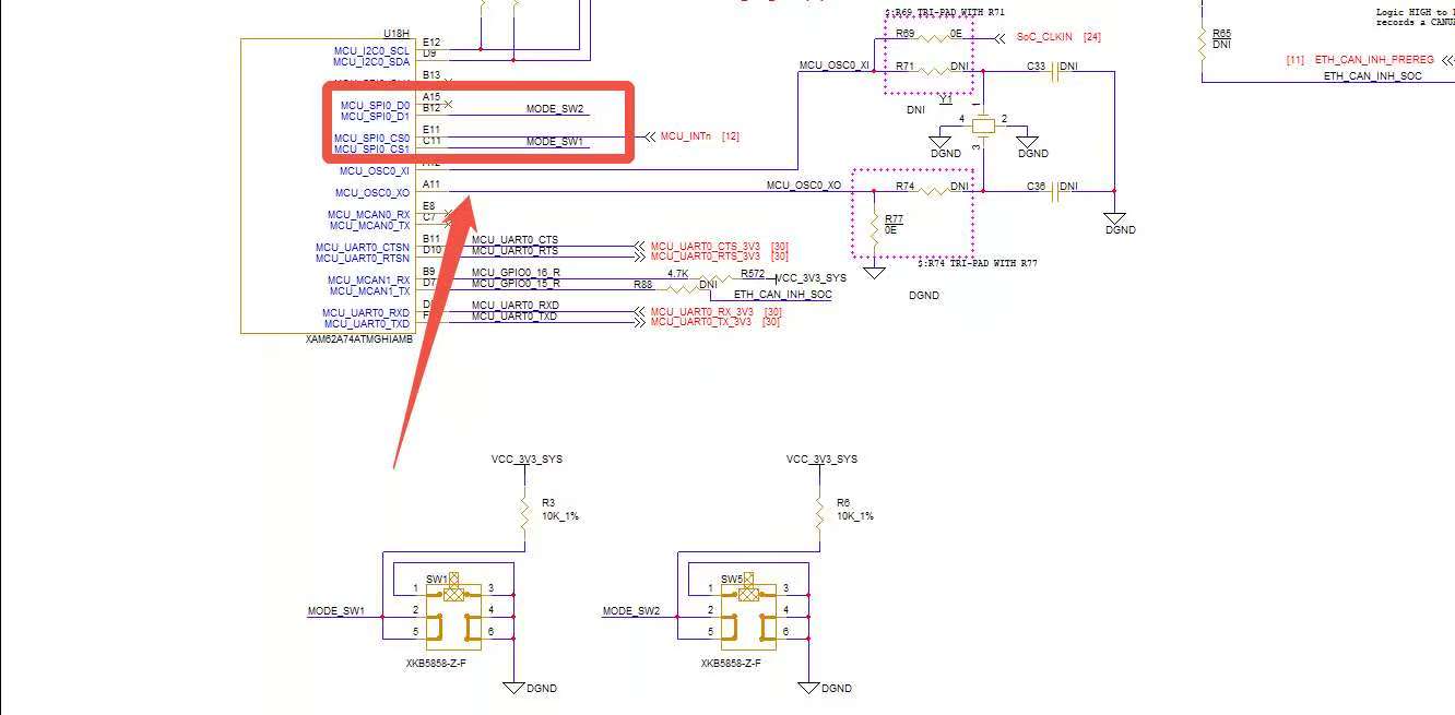

    AM62P treatment on unused pins
    Most LVCMOS pins will be turned off by default, so these pins can be left unconnected if software never enables the input buffer associated with a pin. A pin which has its input buffer enabled must never be allowed to float to a mid-supply voltage greater than VILSS and less than VIHSS. Input buffers may be damaged if it spends too much in the mid-supply region.
    Most of the AM62Px IOs default to mux mode 7, which selects the GPIO signal function. The IO cells associated with these pins default to an off state, where the input buffer is turned off, the output buffer is turned off, and the internal pulls are turned off. It is possible to allow these pins to float as long as software never turns on the input buffer with the RXACTIVE bit in the respective PADCONFIG register. You should never allow any of these pins to float to a mid-supply level between VILSS and VIHSS while the input buffer is enabled because exposure to this condition could damage the input buffer. We limit the time allowed in this mid-supply region when the input is enabled by defining a minimum input slew rate for each buffer type in the Electrical Characteristics section of the datasheet.
    They must not allow the pin to float if the RXACTIVE bit is set high. Did they set the RXACTIVE bit high in the PADCONFIG register? If so, they need to change the RXACTIVE bit to be low, so the input buffer is disabled.
    The OSPI0_LBCLK0 pins operates as an input in the "Pad Loopback" clocking topology, where the clock goes out through the output buffer associated with the OSPI0_LBCLK0 pin and loops back through the input buffer associated with the same pin and this looped back clock is used to capture read data.
    The "DQS" clocking topology provides the best option for compensating for AM62Px input/output delays, PCB board delays, and attached device clock to data delays. This is the recommended clocking topology when the attached device has a DQS output.
    The "External Board Loopback" clocking topology provides the next best option by compensating for AM62Px input/output delays, PCB board delays. This clocking topology doesn't compensate for attached device clock to data delays. This is the recommended clocking topology when the attached device doesn't have a DQS output.
    The "Pad Loopback" clocking topology only compensates for AM62Px input/output delays. This clocking topology is not typically used because the two clocking topologies described above are better options.
    AM6422: CPSW Timing
    The minimum input slew rate defined for AM64x is equivalent to the input rise/fall time requirements defined for the PHY. A 20% to 80% or 80% to 20% voltage change is a voltage change that is equal to 60% of VDD. In your case, VDD is 3.3V and 60% of 3.3V is 1.98V. Changing the signal by 1.98V in 0.75ns gives a slew rate of 1.98V/0.75ns = 2.64V/ns. So, the requirements are the same for both devices and matches the signal rise/fall times defined in the RGMII standard.
    Measuring the rise/fall time at the source end of an LVCMOS signal can be misleading. The voltage at the source end of the signal only steps up to a mid-supply potential until the signal has time to propagate down to the far end of the signal trace and the high impedance connection at the far end returns an in-phase reflection to the source. Therefore, measuring a 20/80 rise/fall time at the source will include 2x the PCB trace propagation delay in your measurement. The far end of the signal trace doesn't see this additional delay. I suggest you find a place to probe the RX_D1 signal near the AM64x device to get an accurate rise/fall time measurement for the RX input. Otherwise, you could subtract about 0.334ns for each inch of signal trace from the measured value at the source to get a value that is close to what is seen by the RX input. For example, you would subtract 1ns from the 1.7ns fall time measurement if you have 3 inches of PCB trace between the probe point and the RX input pin.
    AM623: GPIO input slew rate
    The minimum Input Slew Rate parameter defined in each Electrical Characteristics table is associated with long-term reliability. These parameters are not a function of the ST_EN bit. Note: We never expected software to disable hysteresis on any of the input pins. This is a mistake that needs to be fixed.
    The minimum Input Slew Rate parameter defined in each peripheral timing section is a requirement to meet the respective peripheral timing parameters.
    The device may not work as expected if you violate the minimum input slew rate limit defined in the respective peripheral timing section, but the device could be permanently damaged if you violate the minimum input slew rate limit defined in the respective Electrical Characteristics table. It is very important that you minimize the time a signal connected to one of our input buffers spends in the mid-supply region as it transitions from low to high or high to low.

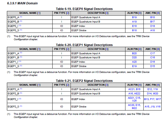

    Several of the AM62x GPIO have an internal debounce circuit in their path to the GPIO module, which can be configured to filter a noisy signal. This would be a better solution than applying an external RC filter that slows the signal slew rate. See Note1 attached to each GPIO Signal Description table in the datasheet to know which GPIO inputs have the debounce feature. GPIO1_30 does not have the debounce capability.
    The Schmitt Trigger function implemented in the input buffer only changes the output results of the input buffer, by filtering noise pulses that do not exceed the hysteresis.
    The Schmitt Trigger function does not change how the input buffer is compromised when a system applies a slew rate to its input that is slower than defined in the datasheet.
    The product must be designed to be in compliance with our datasheet requirements. If not, the non-compliance could reduce the life of the AM62x device

    1) What's the max current input and output for SDIO DATA/CMD line? (2) What's mean for "input leakage current"?
    (3) Could we "remove" external PU resistor for SDIO communication? (connect device is WiFi module, not eMMC or SD)
    Because of PCBA space limitation. we try to remove external PU resistor, and we found SDIO level become 1.2V. Does it have side effect?
    (4) Does SDIO interface support internal PU resistor by register setting? Could we use internal SDIO PU resistor to replace external resistor?
    We define output current as IOL and IOH parameters, which is the minimum Low Level Output Current and High Level Output Current for which the device is able to maintain the specified VOL and VOH values. Values defined by these parameters should be considered the maximum current available to a system implementation which needs to maintain the specified VOL and VOH values for attached components. You will need to use the AM62x IBIS models in a simulation to determine VOL or VOH levels for a specific current.
    We plan to include the following input leakage note in the next revision of the datasheet. Hopefully, it helps explain what this parameter defines.
    This parameter defines leakage current when the terminal is operating as an input, undriven output, or both input and undriven output, without internal pulls enabled.
    Most of the AM62x pins will be turned off after power-up. This means the input buffer is disabled, the output buffer is disabled, and the internal pulls are disabled. Please reference the Pin Attributes table in the datasheet to see the initial power-up state of each pin. You may need to have external pull resistors on any signals that connect to inputs of attached devices to prevent them from floating until software configures the associated IO cell.
    You can use the AM62x internal pull resistors if an external resistor is not required to hold inputs to a valid state while waiting for software to configure the internal resistors.
    one question, Do we have minimum Low Level input current and High Level input Current for SDIO? Base on "7.8.5 SDIO Electrical Characteristics", I do not see related parameter. So I am not sure this is a right question.
    The max input leakage is defined for the two worst-case conditions, which occurs when the voltage applied to the input is 0V or the IO power rail potential. See the test conditions associated with the input leakage current parameter. We do not define input leakage at VIL or VIH, but the leakage current will decrease as the voltage potential applied to the input moves away from either of the two test conditions.

    The datasheet publishes VOH and VOL parameters for the LVCMOS buffer type in the Electrical Characteristics section. These parameters represent the device output voltage for a specific drive current."
    Additional inputs:
    The AM335x outputs were not designed to support continuous drive of large steady-state current. They were designed to drive CMOS inputs which only requires a transient current to change the signal logic state and potentially a small steady-state current to hold a logic state by over-driving weak pull resistors.
    The datasheet publishes VOH and VOL parameters for the LVCMOS buffer type in the Electrical Characteristics section. These parameters represent the device output voltage for a specific drive current. This single data point is all we provide. You would need to use the information provided in the IBIS file to simulation output voltage for any other current.
    Refer below input on the LVCMOS slew
    What is the applicable range of the throughput rate spec? It is from 10% to 90%
    Inputs related to pin capacitance
    The IBIS models have C_pkg (package capacitance, universal min/max for all pins) and C_comp (die capacitance, unique for each buffer type) that can be combined together to get the total capacitance for a pin.
    My customer  is asking about VIH/VIL condition for GPMC0_AD0. Below is the spec on the datasheet.
    What is the condition of input voltage for slew rate spec? Can we refer to below, which means delta t(sec)/(0.65*1.8V - 0.35*1.8V) = delta t(sec)/0.54V?
    The signal swing limits used for AM65x timing closure was 25/75
    (3) AM623: AM62x: MCAN Input Slew Rate: 0.0018 V/ns or 2...15 V/ns? - Processors forum - Processors - TI E2E support forums
    In Chapter 7.8.6 "LVCMOS Electrical Characteristics", the parameter SRI (Input Slew Rate) specifies a minimum input slew rate of 1.8E+6 V/s = 0.0018 V/ns
    However, in Chapter 7.11.5.13 "MCAN Timing Conditions", Table 7-69
    specifies an input slew rate of = 2 V/s ...15 V/ns  for the MCAN interface.
    Could you please clarify how these two specifications are related?
    Is the 2...15 V/ns value a functional requirement for the MCU_MCANx_RX inputs, or is it only the input slew-rate condition used for characterization of the timing parameters in Table 7-70?
    The 2...15 V/ns range appears significantly higher than the general LVCMOS slew-rate requirement and also seems unusually demanding for a standard CAN/CAN-FD receive path.
    The input slew rate limits in the electrical characteristics tables are required to ensure long-term reliability for the input buffer.
     The input slew rate limits in the timing sections are required for the respective peripheral timing parameter values to be correct.
    AM625: Disturbance on OSPI CLK connected to SPI NOR
    Providing multiple chip select pins on this peripheral makes someone think they can connect multiple devices, and is expected to understand the implementation is very problematic.
    The problem with connecting multiple devices is related to your observation on the clock. You see this distortion on the source end of the signal trace because the output buffer has about the same source impedance as the signal trace. When the signal changes from low to high or high to low, the voltage applied to the signal is divided by the ratio of output buffer source impedance and the signal trace impedance. It is basically a voltage divider that results in a mid-supply voltage being applied to the signal. This mid-supply voltage propagates down the signal trace until it encounters a high-impedance or open-circuit, where the mismatch in impedance results in an in-phase reflection that causes the voltage at the far end to make a continuous transition from VDD to VSS or VSS to VDD. This reflection returns back to the source, where the voltage at the source will not continue to VDD or VSS until this reflection has returned. The length of the mid-supply step function will be equal to two times the propagation time of the clock signal trace. The step function gets shorter as you get closer to the end of the signal trace, but not completely gone until the very end.
    A device connected anywhere other than the far end of the signal trace will observe the same step function on the clock signal. Connecting a device clock input anywhere in the middle of a clock signal trace is a very bad design practice because there is a good chance the output of the clock input buffer of this device will generate internal clock glitches when this mid-supply voltage pauses near the switching threshold of the input buffer. You cannot split the signal trace into two paths without creating impedance discontinuities which also causes signal distortion. Inserting buffers will resolve the impedance mismatch issue but inserts delay in the clock path, which may cause a timing violation because the peripheral was timing closed assuming a direct connection without any buffer delays.
    Connecting your NOR memory device to the middle of the clock signal was a mistake. You must resolve this issue by disconnecting any signal trace that extends beyond the attached device to prevent any internal clock glitch issues.
    Most of the AM62x pins power-up turned off, so you need include external pull resistors to hold any attached device inputs in a valid logic state until the IOs and associated peripheral module has been initialized by software. You should never allow CMOS inputs to float. this is especially true for the AM62x inputs. All AM62x inputs which have been enabled must be held in a valid logic state that is above the VIHSS or VILSS as defined in the respective electrical characteristics section of the datasheet. The AM62x device could be damaged if your design allows any enabled inputs to float to mid-supply voltages for an accumulated period of time over the life of the product.
    https://e2e.ti.com/support/processors-group/processors/f/processors-forum/1164397/am625-disturance-on-ospi-clk-connected-to-spi-nor/4388721
    Sreenivasa

    Supported pullup or pulldown for IO buffer type SDIO, eMMCPHY, LVCMOS and configuration during reset and after reset
    ould you please provide the permissible resistor value range when fixing the voltage externally for the SoC input pins? Specifically, I would like to know the acceptable range when pulling the pins High or Low on the board.
    I would prefer to connect with the lowest possible impedance.
    For confirmation, please also advise on the following pins (some were previously inquired about):
    • RESET input pins: MCU_RESETz, RESET_REQz
    • BOOTMODE pins
    Any though on why you would want to use a low impedance resistor?  I assume you may be concerned with noise coupling to the signal if only connected with a high impedance pull.  If this is the concern, keeping the signal trace short is just as important since long signal traces can act like an antenna and pickup noise.  If they have a long signal trace connected, I would recommend placing the low impedance pull-up near the processor input pin so the unterminated high impedance end of the signal trace develops the voltage potential when noise is coupled into the signal trace rather than the low impedance terminated end of the signal trace.
    Considering worst case scenario with calculations based on the Sections, Recommended Operating Conditions and LVCMOS Electrical Characteristics of the AM62Px Datasheet:
    I assume you reuse the SK-AM62P-LP schematic, and VDDSH3=3.3V. In worst case, the LVCMOS High and Low output levels to be: VOH(max)= VDDSHV3max =3.465V  and VOL(min)=V_gnd = 0V
    Under "boot mode pins wrongly initialized by SW as outputs" scenario you should have PU and PD load current limited to:
    With PU=2k: I_OL = ( VDD(max) - VOL(min) ) / Rpd ~ ( VDDSHV3(max) - V_gnd ) / Rpu = ( 3.465 - 0V ) / 2k = 1.73 mA < IOL(VOL_MAX) = 5 mA
    With PD=2k: I_OH = ( VOH(max) - V_gnd ) / Rpd ~ ( VDDSHV3(max) - V_gnd ) / Rpd =  ( 3.465V - 0V ) / 2k = 1.73 mA < IOH(VOH_MIN) = 9 mA
    Therefore using highest possible in the range 1K ... 2K shall be ok.
    Although the above calculations are within the data sheet spec this current is expected to be sourced or sunk for a short duration.
    If the bootmode pin is expected to be an output for unexpectedly long time, the recommendation is to reduce the current.
    A 10K or worst case 4.7K is recommended in these use cases.

    The PADCONF regs can independently enable or disable the input path (RX_ENABLE) and the output path (TX_DIS). This might conceptually be done to minimize power consumption. Or as another example, you may want to "guarantee" that a particular GPIO is limited to functioning as an input (RX_ENABLE=1) and should never be allowed to "accidentally" drive an output (TX_DIS=1) (though "accidentally" having GPIO to drive an output can only happen in the case of a software bug)
    Once those two buffers are enabled, then the MUXMODE dictates which IP can dynamically control the corresponding IO.
    If for example you're in GPIO mux mode ...
    At any given instant the output path can be high-z or actively driven. If you tell the pin to act as an output, then the GPIO module drives the "output_enable" of the IO buffer (making it "not" high-z) and the output value from the GPIO module is driven on the output *and* reflected back on the input path if the RX_ENABLE is enabled. And the GPIO IN value will reflect the state of the output value.
    If the RX_ENABLE is "disabled" then you would not see the GP In reflecting the GP Out.
    Similarly, if TX_DIS=1 then the GPIO "output enable" is gated off and regardless of what is set in GP OUT will not reflect on the output pad.
    Additional inputs i received from our device expert for TX_DIS.
    This bit was added because the pin mux logic is not glitch free when changing modes. For example, the pin mux logic may connect the output of any of the signal function to the IO cell for a very short duration when switching from one mode to another. This may cause the attached signal to glitch to an unknown logic state or multiple unknown logic states before settling to the logic state of the newly selected signal function. This glitch may be undesirable for some applications. If that is the case, the TX_DIS bit provides a way for the application software to force the output buffer off before making the mode change. Note: The attached device may require an external pull or the internal pull to be turned on to hold the signal in a known state while the TX_DIS bit is set. The input buffer associated with the IO on our device will have a similar requirement if the input buffer is enabled with the RXACTIVE bit. An alternative for protecting our IO would be to turn off the associated input buffer before turning off the output buffer.
    Once the mode has been changed, the TX_DIS bit can be returned to its functional state. The RXACTIVE could be turned back on if it had to be turned off. Then software can begin using the new signal function.
    In some cases the application may not care if the signal glitches. If so, this process of disabling the output buffer during a mode change may not be necessary.

    Inquiry on TX_DIS Configuration for LVCMOS (RGMII1) Pins Used with MUXMOD: 0
    The TX_DIS bit in the PADCONFIG registers provides a way to over-ride to the output enable signal coming from the internal module selected by the pin mux logic. When set high, the output buffer will be forced off.
    This function was added to the IOs as a way to force the outputs off when switching mux modes because the pin mux logic is not glitch free. It is possible for the outputs to be driven to unexpected states when changing mux mode values. For example, let's say you were switching from mode 8 to mode 1, neither of these mux modes are driving the buffer, but mode 3 associated with this IO is driving a high logic state. The pin mux logic may transition through mode 3 on its way from mode 8 to mode 1. If so, the output buffer will try to drive the high logic state on the device pin for a few ns as the pin mux decode logic settles.
    You are expected to set TX_DIS bit high before changing the mux mode value and change it back to low if the selected signal function is an output.

    If the UART RXD pin is muxed to the UART peripheral and the output buffer is automatically disabled by the peripheral, is my understanding correct that such unnecessary current consumption does not occur in this case?
    This is correct. the output buffer will be disabled in the UART RXD case.
    4.I would like to ask you to confirm the following point.
    I understand that the TX_DIS setting is not effective when the MUXMODE is set to anything other than GPIO. Is my understanding correct?
    This is not correct, the TX_DIS overrides any MUXMODE selected peripheral.
    AM62P-Q1: Regarding UART RXD Pin Configuration (TX_DIS=0) in SysConfig “Debug Log” Section
    1. Is it correct that there is no issue using the UART RXD pin configured in the SysConfig “Debug Log” section with TX_DIS set to 0?
    In other words, even if TX_DIS remains set to 0 for a pin muxed to UART RXD, does this configuration cause no functional or electrical problems?
    The TX_DIS pin is used to to disable the output driver when changing mux modes as detailed in the TRM, Table 14-13128, note 3.
    To prevent unwanted glitches, software should disable the output driver by setting the TX_DIS bit before writing a new MUXMODE value. Once the new MUXMODE value is written, the TX_DIS bit can be reset in order to re-enable the pin driver.
    When TX_DIS = 0, the output buffer enable is controlled by the peripheral selected by MUXMODE.
    When UART RXD is selected, the output buffer will be disabled.
    2. Where in the Technical Reference Manual (TRM) is it specified that using the UART RXD pin with TX_DIS = 0 (as configured in SysConfig “Debug Log”) is not an issue?
    I would appreciate it if you could indicate the relevant chapter or section describing the control of the output buffer when the pin is muxed to a peripheral (UART RXD).
    There is no TRM content covering the peripheral control of the output buffer. I will file a ticket to have this clarified in a future revision.
    3.It is mentioned that keeping the output buffer ON “will draw a little current unnecessarily.”
    5. If “TX_DIS overrides any MUXMODE‑selected peripheral,” then when MUXMODE is configured to “UART RXD,” I would expect the UART to set TX_DIS=1. In my testing, however, TX_DIS remains 0. Could you explain why? Also, in your previous response you indicated that, even with TX_DIS=1, the output buffer would be disabled under this configuration. Could you please confirm whether this understanding is correct?
    TX_DIS is an override control. IP's do not directly write to this bit, hence you do not see any change when selecting an input only signal via MUXMODE. Conceptually this is the setup..
    Sreenivasa

    Characteristic Impedance at the input pin of an IC
    I have question. It may appear very basic question. But still I would like to ask. Question is regarding "Characteristic Impedance"
    If you below figure (which represents some arbitrary digital design interfacing uC to a memory)
    Generally we say, impedance through out the digital transmission line should be same in order to eliminate any reflection; that is why we choose 50Ω everywhere. Nowadays, since most of the microcontrollers/processors have On-Die Termination (50Ω) we do not put any series termination; And we generally route every digital trace whos characteristic impedance is 50Ω.
    So, from signal propagation point of view; the on the sending end side (after the push-pull amplifier) the signal sees 50Ω because of ODT. Also on the PCB trace because we maintain the trace-width ground separation to have 50Ω. But, when signal reaches the receiving end (e.g., memory) it is having high input impedance (generally in MΩ)
    My question is, is it not result in signal reflection because of mismatch of impedance at the load end?
     mismatch in impedance will cause reflections but this tends to only be an issue if there is a second input connected to the circuit.
    Current will be injected into the transmission line when the output buffer toggles. The resulting voltage launched on the transmission line will be a ratio of the output buffer impedance and the transmission line characteristic impedance. Lets assume the buffer output impedance is equal to the transmission line impedance for this discussion.
    In this case, the voltage launched on the transmission line will be 1/2 of VDD. This potential will propagate down the transmission line until it encounters an open-circuit at the far end. An equivalent amplitude is reflected back when the signal encounters the open-circuit, which means the input buffer will see a continuous voltage swing of VDD. The reflected signal will propagate back to the source where it is properly terminated since the output impedance of the buffer is equal to the characteristic impedance of the transmission line.
    So this works great as long as you have a point to point connection between two devices. However, this can be problematic if you attempt to connect any other input buffers to the transmission line since only the far end will experience a continuous voltage swing equal to VDD.
    Other points along the transmission line will experience a transition to 1/2 VDD for a brief period followed by another 1/2 VDD transition. These two transitions creates a voltage step between the two transitions, where the length of the step depends on the length of the transmission line and the position along the transmission line where you observe the signal. The max length of this step occurs at the source, where it will be 2x the propagation delay of the transmission line.
    It is common to see a series termination resistor inserted near the source. This allows a resistor to be used to match the output buffer impedance to the transmission line characteristic impedance. The returned reflection is completely absorbed when the impedance is matched. So there are no other reflections on the transmission line as the result of the initial toggle.
    peaves said:
    voltage launched on the transmission line will be 1/2 of VDD. This potential will propagate down the transmission line until it encounters an open-circuit at the far end. An equivalent amplitude is reflected back when the signal encounters the open-circuit, which means the input buffer will see a continuous voltage swing of VDD,
    Sorry for delayed reply. And Thank you for the detailed explanation.
    When I read the quoted lines, I felt like we are talking here about "Reflected Wave Switching". Am I correct? Does it holds good for any interface like SDR/DDR/SPI etc?
    My description describes transmission line physics, where the same thing happens regardless of interface type.
    Reflective Wave Switching works well as long as you have a point to point connection between two devices and the only input buffer is located a the far end of the transmission line. However, it can be problematic when trying to attach more than one input buffer along the transmission line. For example, you would never want to use Reflective Wave Switching for a multi-drop clock signal since any mid-point input buffers may produce clock glitches during the transition step. Reflective Wave Switching can be used for a multi-drop synchronous data bus as long as each drop doesn't create stubs and the reflection is given time to return to the source before the data bus value in latched.
    Queries related to GPIO grouping and supply connection:
    Refer 6.3 Signal Descriptions for IO related to the DPI
    Table 6-9. DSS0 Signal Descriptions
    The table lists all the signals used for DPI interface
    A number of LVCMOS IOs  are grouped together and a common supply for the group IO supply for IO group VDDSHVx is the supply referenced for the whole group.
    Each of the IO supply group can be sourced by a fixed 1.8V or 3.3V supply.
    Refer 6.2 Pin Attributes section of the data sheet for the GPIO information related to IO supply for IO group.
    The DPI signals (VOUT0_) are referenced to IO supply for IO group VDDSHV3
    The IO buffer type is LVCMOS
    Refer below section for the specs
    7.8.6 LVCMOS Electrical Characteristics
    The IO levels is recommended to be above VIHSS or below VILSS.
    The links to the data sheet and other collaterals are provided in the below FAQ
    https://e2e.ti.com/support/processors-group/processors/f/processors-forum/1183910/faq-am625-custom-board-hardware-design-collaterals-to-get-started
    Sreenivasa
    Refer below for GPIO timing and slew rate
    7.11 Timing and Switching Characteristics
    (+) [FAQ] AM623: MMC0 HS200 slew rate - Processors forum - Processors - TI E2E support forums
    1) We only define Input slew rate for modes which have specific or fixed input timing requirements. The clock output to data capture time relationship is not fixed for the HS200 read data path since this mode requires data training. The data training algorithm used a known data pattern to select a data capture time that is centered in the data valid window. There is no specific input slew requirement since tuning searches across an entire bit time to find the center of the data valid window. However, the width of the data valid window is a function of input slew. The signal transition needs to be fast enough to provide a reasonable data valid window for the data training algorithm.
    2) It is very important to limit the amount of time the applied signal spends within the voltage region between VIHSS and VILSS. The minimum input slew rate limits are required to ensure long-term reliability of the input buffer.
    The minimum slew of 1.8E+6V/s (1000ns when operating at 1.8V) is not a function of toggle frequency and it represents the slowest signal that can be applied to the AM62x input buffer. The minimum slew of 18fV/s (0.5ns when operating at 1.8V with a 200MHz toggle) is a function of toggle frequency and represents the minimum slew rate allowed for a specific operating frequency. The limit of 18fV/s is the more restrictive of the two limits, so this is the requirement to ensure long-term device reliability. In some cases, a specific peripheral may have a more restrictive requirement to ensure timing.
     See Note 5 associated with the Input Slew Rate parameter, SRI. The note defines which value applies by saying "Select the MIN parameter which results in the largest value".
    The non-frequency dependent limit of 1.8E+6V/s becomes the larger value when the signal toggle rate is less than 100kHz.
    The frequency dependent limit of 18fV/s becomes the larger value when the signal toggle rates is greater than 100kHz.
    The slew rate has frequency dependency.
    1,8V mode
    3.3V mode
    A max slew of 1000ns is recommended when the signals toggle rate is not high (non-frequency dependent limit)
    We basically need to limit the amount of time the input buffer is exposed to a mid-supply potential. The concern is related to the effect on reliable operation of the input buffer caused by shoot-through current that flows from VDD through the input buffer to VSS as the signal transitions through the mid-supply region. The slew rate limits ensure the device is not exposed to this condition for too long over the life of the board.
    We only care about the signal slew rate that is applied to an enabled AM62x input buffer.
    The slew rate is not a concern for CLK signal as long as they turn off the associated input buffer with the respective RXACTIVE bit. This will not be possible for the IOs associated with the DAT/CMD signals since they are bidirectional. The external series resistor should provide some isolation from the load when AM62x is driving DAT/CMD, which should allow the signal to have a faster slew rate at the AM62x pin. We are only concerned with the signal slew rate on the AM62x pin since that is what is sourcing the AM62x input buffer. The external series resistor should not have a big impact on the signal slew rate at the AM62x pin when the attached device is driving DAT/CMD.
    They need to be measuring the signal slew rate of the AM62x pin. Where are they measuring the signal slew rate?
    The eMMC clock in AM62x is not looped back for retiming. AM335x did not have internal delay lines that could be used to optimize timing, so the clock was looped back at the pad to help compensate for the some of the delay inserted in the roundtrip time associated with read operations. It would not be possible to close timing for the faster data transfer rates supported in AM62x without having the internal delay lines. You do not need to loopback the clock once you have internal delay lines to compensate for external delays.
    When you say they are measuring slew rate close to AM62x, are they probing on the actual device pin.  If not, the measured slew rate will not be the same that is seen by the AM62x input buffer. For example, the measured slew rate will have a 100ps mid-supply step include in the slew rate measurement if they probe the signal 0.3 inches from the AM62x pin. The mid-supply step gets shorter as you probe closer to the AM62x pin and gets longer as you probe further from the AM62x pin. The slew rate measurement is only accurate when probing the signal at the AM62x pin.
    You mention competitor devices do not have similar slew rate requirements. This may be the case if these devices were implemented in a less-advanced process node, where the circuit geometries are larger. It may also be possible that competitors do not understand the risk associated with an input speeding too much time in the mid-supply region.
    The mid-supply step will be equal to 2 times the PCB trace delay at the output buffer. The mid-supply step will be equal to zero at the input buffer connected to the far end of the PCB signal trace. The mid-supply step decreases from 2 times the PCB trace delay to zero as you move the probe from the source to the end of the PCB signal trace. The mid-supply step will persist for the time it takes the signal to propagate past the probe to the end of the PCB trace and return back to the probe. The average propagation velocity of a PCB signal trace is about 167ps per inch. In my previous example, probing 0.3 inches from the AM62x pin, it would take the signal 0.3x167ps = 50ps to travel past the probe to the end of the PCB signal trace, then it would take another 0.3x167ps = 50ps for the signal to return to the probe. This step will add 100ps to any rise/fall measurement, which can have a significant impact on measured slew rate.
    There are multiple reliability concerns. One is aging, that causes propagation delay through internal circuits to degrade over time. The CLK output path and the DAT/CMD output path may not age at the same rate, which means one signal can get slower over time relative to the other signal. The timing closure team may have already accounted for the delay degradation associated with the different toggle rates, where they based the timing impact on our recommended min input slew rate. Violating the recommendation could cause timing violations over time.
    It is going to be very difficult to analyze all of the concerns with violating the recommended min input slew rate. The customer needs to make an effort to meet our input slew rate requirements.
    About Input Slew Rate of LVCMOS in Datasheet
    I have two questions.
    1.LVCMOS in IBIS model has two types, LVCMOS_H and LVCMOS_V.
    Is the slew rate spec same both types?
    2.You say slew rate of the electrical characteristics is related to reliability.
    Is it same to all peripherals?
    The slew rate defined in the Electrical Characteristics tables are a function of the IO cell reliability. The slew rates defined in the various Timing Conditions tables are a function of peripheral timing.
    Propagation delay through input buffers will increase as the slew rate decreases. The effect of slew rate must be considered for short duration timing parameters. However, the RST3 parameter is not one of those short duration timing parameters. The slew rate influence on the RST3 parameter is not significant.

    This is a valid concern. Applying a mid-supply potential to any CMOS input buffer that is enabled will partially turn on both p-channel and n-channels in the input buffer. This causes shoot-through current to flow from the IO supply to ground. This shoot-through current could damage the input buffer if the condition remains for extended periods of time. Therefore, it is important for the system design to turn off any conflicting internal pulls as soon as possible.
    Based on the register values provided in the table above, ROM code appears to be turning off the internal pulls before it begins the boot process. So this concern is already being addressed by the eMMC boot ROM code. This could be a problem if a eMMC device is connected as described above and the eMMC boot ROM code never executes. Your system software would need to take care of this if you select a different boot mode and the ROM code never turns off the pull-downs.
    I would recommend adding external pulls in addition to the conflicting internal pulls, where the external pull impedance is able to pull the signal to a valid logic level until one or both internal pulls can be turned off. This will minimize the risk if the system encounters an unexpected event that prevents it from booting and the intermediate level is applied for a longer period than expected.
    Are they asking if it is okay to leave the conflict which applies a mid-supply potential when the signal is not driven by one of the attached devices? For example, a bidirectional data signal that is driven most of the time but occasionally not driven by either device when there is a data direction change.
    If so, this is not recommended. This use case could cause long-term reliability issues for the input buffer since the accumulated time spent in the undesired mid-supply region could add up to a significant amount of time over the rated POH of the device.
    If their use case is different than my description above, please provide more details.
    They should limit total accumulated exposure time to this condition.
    Shoot-through current will look like a narrow bell-shaped curve when plotted on the y-axis with respect to input voltage on the x-axis, where the current peaks as the input voltage reaches approximately VDD/2. The primary goal needed to reduce long-term reliability risk associated with an intermediate voltage is reducing shoot-through current by getting the input voltage as close as possible to VSS or the respective VDDSHVx power rails.
    The JEDEC eMMC standard only defines internal pulls for DAT[7:1] pins and requires the eMMC deice to turn off these internal pulls once it is configured to transfer data on these pins. So eMMC internal resistors should be off when the device is being used and the system software should have already turned off the internal conflicting pull-down resistors in AM437x. So there should be no concern with intermediate voltage during normal operation.
    I agree, the signal will have three pulls connected before software is initialized. There is no concern from the JEDEC eMMC standard perspective with this combination of pulls being outside of the 10k to 150K range until communication begins. So you should be able to use a 10K external pull on these signals since the internal pulls will be turned off before communications begins. This will pull the input as high as possible without violating the JEDEC eMMC standard pull-up requirement.  I'm not sure what the input voltage will be while all three resistors are enabled, but hopefully the external 10K pull-up is able to pull the voltage high enough above the VDD/2 potential that shoot-through current is significantly reduced.
    Q1. Is there any problem to pull down the external pull-up resistor with a lower value
    than that specified by JEDEC?

    (+) Meaning : Min/Max of Clload (Output load capacitance) - Processors forum - Processors - TI E2E support forums
     I want to know the meaning of Min/Max Cload.   AM335x Datasheet said "GPMC Cload (Output load capacitance) is MIN 3pF, MAX 30pF" as follows.
     My understanding is that  when "the capacitor of between 3pF and 30pF" is attached on one of GPMC pins as the external load, AM335x can work under the datasheet timing.  Is it correct??  Please let me know.
    Yes, you are correct.  Timing parameters are verified with AM335x operating within the operating conditions defined in the Recommended Operating Conditions section of the data manual with a capacitive load in the range of 3 - 30 pF.

    Inputs on LVCMOS input slew rate (MCU_PORz)
    (+) [FAQ] AM625 / AM623 / AM620-Q1 / AM625-Q1 / AM625SIP: MCU_PORz input slew rate - Processors forum - Processors - TI E2E support forums
    A 22 pF glitch filter is recommended at the input of MCU_PORz
     another important point about the MCU_PORz input slew rate. It is very easy for noise to couple on slow rising signals such that it creates non-monotonic transitions. Your MCU_PORz reset source needs to be monotonic to prevent the chance of creating glitches on internal reset as it transitions through the input buffer switching threshold. A faster slew rate on the MCU_PORz will increase your system noise immunity. The min slew rate defined in the AM625 datasheet is acceptable to the AM625 device but may not be acceptable for your system noise immunity requirements.
    Please keep in mind the AM62x device requires the MCU_PORz input to have a maximum rise/fall time of 1000ns. This may be difficult to achieve with a pull-up on a signal sourced from an open-drain output buffer. You may need to buffer the open-drain signal with a push-pull buffer that has hysteresis on its input to ensure the AM62x device never receives a short reset pulse that violates the minimum pulse duration defined in the "MCU_PORz Timing Requirements" table. For example, it may be possible for noise to couple on the slow rising open-drain signal just as it crosses the input buffer threshold which could cause a short glitch on the reset signal. Normal device operation could be compromised if this occurs.
    Sreenivasa
    Inputs regarding PADCONFIG register ST_EN bit configuration
    We expect hysteresis to always be turned on for every input that is controlled by a PADCONFIG register.
    The default state of the ST_EN bit, which controls hysteresis, is “1” in every PADCONFIG register.
    This bit should not be changed to disable hysteresis.
    Disabling hysteresis makes the device susceptible to internal glitches which can cause unpredictable problems."
    Customer has now confirmed that GPIO event counting works correct once hysteresis is enabled on the pin.
    What do you consider the best way to solve the issue in HW in future? Are our Schmitt Trigger gates providing sufficiently fast signals?
    e.g. "The SN74LVC1G17 is a high drive CMOS device that can be used for a multitude of buffer type functions where the input is slow or noisy."
    The Schmitt Trigger function (ST_EN) implemented in the input buffer only changes the output results of the input buffer, by filtering noise pulses that do not exceed the hysteresis.
    The product must be designed to be in compliance with our datasheet requirements. If not, the non-compliance could reduce the life of the AM62x device.
    The hysteresis was accidently turned off when this was never expected, but in reality, it has highlighted a system design error that violates the minimum slew rate allowed to the input buffer.
    We define a minimum slew rate in the SOC datasheet for inputs and this creates a maximum rise time requirement. The rise/fall time for the reset signal must be less than 1000ns, not greater than 1000ns. To ensure your design meets this requirement, you may need to use a buffer between the PMIC and SOC or select a pull-up resistor value that is strong enough to charge your PCB parasitic capacitance and the SOC input capacitance in less than 1000ns. A rise significantly faster than 1000ns is preferred to minimize the potential of noise coupling to the reset signal.
    Now I undesrstand the nRSTOUT for MCU_PORz must be less than 1000ns.
    So I checked nRSTOUT. And it's rise time is 358.4ns. Fall time is 2.569ns . So they are OK.

    (+) AM2432: The GPIO external 10K resistor is pulled up, but the GPIO pin level is not monotonic during the power on process - Arm-based microcontrollers forum - Arm-based microcontrollers - TI E2E support forums
     We found in our testing that multiple GPIO external 10K resistors of AM2432 were pulled up to VCCIO, which was 3.3V. However, during the power on process, the GPIO pin level was not monotonic. We synchronously tested the GPIO level and the VCCIO level when powered on together, as shown in Figures 1 and 2. The VCCIO level was monotonic, so this problem is not caused by the power supply. I have consulted a lot of information, and my conclusion is that many GPIO of AM2432 are in a floating state during the reset period and after reset release (but before software initialization), which makes the parasitic capacitance of the pins easy to cause interference during power on. Is my understanding correct? We hope TI can provide me with a more authoritative and credible explanation regarding this issue. Thank you!
    Figure 1 and 2 GPIO Y7 test power up
    Figure 3 and 4 GPIO V7 test power up
    The IO cells implemented on pins Y7 and V7 were designed to operate at 1.8v or 3.3v mode. There is an internal supply detector mechanism that configures the IO in the appropriate mode based on the IO supply voltage level. During the mode transition from 1.8v mode to 3.3v mode or vice versa, it is possible for the IO to produce glitches on the signal. This doesn't cause any issue for the AM243x device.
    You are correct. The IO cell monitors its own power rail and automatically changes from 1.8V mode to 3.3V mode as its IO power supply voltage continues to increase above 1.8V on its way to 3.3V. The opposite will happen as the IO power rail voltage decays. The IO cell will automatically change back to 1.8V mode as the IO supply voltage drops below 3.3V and approaches 1.8V.
    The capacitor connected to pin L13 (CAP_VDDSHV5) doesn't have any effect on the IO cells associated with pins Y7 and V7, which are powered from pins R10, R8, and T9 (VDDSHV2). The glitch you see is not related to the value of any capacitor. It is a function of how the IO cell works. As mentioned in my previous post, there is nothing you can do to change how the IO cell works. However, connecting the wrong value capacitor can cause other problems.
    Typically, a glitch on one of the AM243x pins is not an issue because the entire system is held in reset until all power supplies and clock sources are valid. You may need to insert a signal switch that blocks the glitch from propagating during power up if it is causing problems for your system.

    Refer input related to IO leakage
    When power is supplied and PORz is not released unexpected voltage leaks to UART0_RXD pin.
    The IO buffers for UART0_RXD are off during power-up.
    A pull is recommended when a trace is not connected and a signal is not being driven actively.
    Voltage on an unconnected AM62Px pin is possible. The voltage observed on the pin is the result of leakage paths in the IO buffer, where the leakage can be as much as 10uA to either VSS or VDDSHV. This is normal as long as the leakage is not greater than 10uA. The resulting mid-supply voltage is not a problem for the AM62Px device as long as the receiver (input buffer) in the IO buffer remains off. However, the pin must be driven or pulled to a valid logic level anytime the receiver is turned on. Never allow the input of an enabled input buffer in the AM62Px device to float.
    Note: We recommend external pulls to be used on any signal that connects AM62Px to the input of another device. The external pull is needed to hold the signal in a valid logic state until software turns on the associated AM62Px IO buffer such that it drives the signal to a valid logic state.
    There is a good chance the AM62x device has been damaged by an Electrical Over-Stress (EOS) event if the IO buffer has more than 10uA of leakage with the output buffer and internal pull turned off.
    There is a good chance this device is implemented using a more advanced process node than any of your previous devices. The more advanced process node uses significantly smaller geometries to implement on-die circuits, where the transistors are much smaller and have higher leakage.
    We expect the IOs of any attached device to be powered from the same IO power source that is powering the AM62Px IOs associated with the attached device.
    The IOs associated with the AM62Px device are not fail-safe. This means no external circuit can source any potential greater than the potential applied to the respective IO power rail. See the "Steady-state max voltage at all other IO pins" parameter in the Absolute Maximum Ratings table in the datasheet, where the potential applied to a pin is limited to minimum of "-0.3V" and a maximum of "IO supply voltage + 0.3V".
    The IO power rails of attached devices need to always have the same potential applied to prevent current injection into an IO that has a potential applied greater than the limits defined in the datasheet. For example, if one device is turned on the other device must be turned on, if one device is turned off the other device must be turned off. Their IO supplies also need to track as the power source ramps up or down. The best way to ensure this condition, is to power the IOs associated with both devices from the same power source.
    The ESD protection circuits associated with an IO will turn on if the potential applied is greater than IO supply voltage+0.3V.  This condition will inject current from the external voltage source through the ESD circuits to the IO power rail. We do not allow injection current through the ESD protection circuits because they were only designed to protect the device from short-duration ESD events similar to what would be introduced by a Human Body Model to account for device handling and a Charged Device Model to account for PCB assembly equipment. The ESD protection circuits are not designed for steady-state DC current. They also were not designed to provide any system-level ESD protection once the device has been installed on a PCB.
    The latest concern being discussed is a function of the power-down sequence and effect on the Ethernet PHY. However, there may be similar concerns associated with the power-up sequence and the effect on the AM62Px device.
    The description seems to indicate the Ethernet PHY is powered from the same 3.3V power supply that is also sourcing the PMIC. If so, I suspect the Ethernet PHY receives power before the AM62Px device.  The Ethernet PHY may be applying potential to the AM62Px pins before they are powered. This would be the case if the Ethernet PHY has internal pull-ups that are turned on by default.

    Inputs related to internal pullup value:
    SDIO:
    RPU Pull-up Resistor 40 50 60 kΩ
    RPD Pull-down Resistor 40 50 60 kΩ
    LVCMOS:
    RPU Pull-up Resistor 15 22 30 kΩ
    RPD Pull-down Resistor 15 22 30 kΩ
    (+) AM625: I/O leakage current - Processors forum - Processors - TI E2E support forums
    We only define one value for this parameter, and it is inclusive of all operating conditions.  We do not have additional data for specific operating conditions.
    Please explain how this is creating a problem for your product design to see if I can offer any suggestions.
    10uA is the limit for device pass/fall during final test, so there is a very small probability that you could get some devices that have up to 10uA of leakage.
    You may need to reduce the resistance of the pull-down to ensure the attached device is not enabled by the IO leakage.
    Note: The more advanced process nodes have higher leakage due to the smaller transistors.

    The MCAN0_TX pin is implemented with a LVCMOS buffer type as shown in the datasheet Pin Attributes table. The leakage associated with the LVCMOS buffer type is +/- 10 uA as defined in the LVCMOS Electrical Characteristics section of the datasheet.
    The next revision of the datasheet will have the following note added to the Input Leakage Current parameter to clarify its meaning.

    (+) DRA829J-Q1: Internal Pull down structure - Processors forum - Processors - TI E2E support forums
    Our application uses the DRA829J. Does the DRA829J use internal current sources or real ohmic resistors for its internal pull-downs?
    We want to assure valid logic levels for the DRA829J.For example, our application connects the buffer 74LVC541A to the DRA829J.During normal operation the buffer 74LVC541A is high-impedant and the DRA829J has its internal Pull-Down (max. 30kOhm) activated. When calculating the maximum possible voltage level at this pin, which of the following approaches has to be used:
    • "The leakage current of the high-impedant buffer times the 30kOhm" or"
    • The leakage current of the high-impedant buffer plus the 10µA of the DRA829J-Pin times the 30kOhm"
    The latter approach would always lead to a minimum 10µA*30kOhm=0.3V at the Pin of the DRA829J. (Possibly worsened by e.g. our buffer)
    The decision which approach to use should depend on the internal structure (either current   sources or real ohmic resistors)?
    The processor enables a real ohmic resistor for its internal pull resistors.
    the RPU values are also applicable for 3.3V mode.

    (+) AM2434: GPIO max current sourced/sink on AM24 - Arm-based microcontrollers forum - Arm-based microcontrollers - TI E2E support forums
    What is the GPIO current capability of the AM243
    The explanation on GPIO is not part of the data sheet. Please refer to the TRM
    4.8 General Connectivity
    4.8.1 General Purpose Input/Output (GPIO)
    10.1.3 GPIO Interrupt Handling
    According to the AM243x datasheet, the maximum current that can be sourced or sunk by a single GPIO pin is typically:
     4 mA for low-drive strength, 8 mA for medium-drive strength, 12 mA for high-drive strength, Can you please confirm
    AM62A7-Q1: Interrupt Capable GPIOs ?
    The AM243x datasheet only defines a single data point for current source/sink capability to achieve a specific output voltage (VOL or VOH) in the respective Electrical Characteristics section of the datasheet. The system designer will need to use the device IBIS model to determine the output voltage for any load other than the values defined in the IOL and IOH parameters.
    Note: We only expect our digital output buffers to source CMOS inputs which have a minimum amount of leakage current when driving a steady-state logic level. We do not expect our digital outputs to drive any significant steady-state current.
    See the table note associated with the IOL and IOH parameters.

  • Hi Board Designer,
    May i know what is the period for functional clock as specified in GPIO timing requirement?
    Refer below:
    HFOSC0_CLKOUT -- This is the HFOSC placed on the board. Usually 25 MHz for Sitara SoC boards.
    MAIN_SYSCLK0 -- 500 MHz (Derived from MAIN PLL 0 and this is not allowed to be changed in DM firmware)
    MCU_SYCLK0 -- 400 MHz (Derived from MCU PLL 0 and this is not allowed to be changed in DM firmware)
    GPIO functional clock = MAIN_SYSCLK0 /4
    (+) [FAQ] AM62P-Q1: ePWM period selection - Processors forum - Processors - TI E2E support forums
    (+) AM6442: Need to measure the GPIO frequency from A53 LINUX (or) R5F baremetal - Code Composer Studio forum - Code Composer StudioTm︎ - TI E2E support forums
    (+) AM2434: EPWM module - Can MAIN_SYSCLK0 be modified ? - Arm-based microcontrollers forum - Arm-based microcontrollers - TI E2E support forums
    The MAIN SYS CLOCK is connected to different IP's. So, changing the MAIN SYSCLK will impact on other IPs. so possible but not recommended as can have effect on other IPs.
    (+) AM6442: Signal Frequency - Processors forum - Processors - TI E2E support forums
    According to the SYSCONFIG / AM6x Clock Tree (1.1.4) tool AM6x Clock Tree tool , section Peripherals/General Connectivity/ GPIO0 and GPIO1, the default MAIN_SYSCLK0 frequency is 500 MHz. This means that the default MAIN domain GPIO0 and GPIO1 modules functional/interface clock  frequency is MAIN_SYSCLK0 freq / 4 = 500 MHz / 4 = 125 MHz.
    (+) AM620-Q1: Input Slew Rate - Processors forum - Processors - TI E2E support forums
     AM623: ePWM functional clock
    For other clocks, the defaults can be found here
    AM62PX PLL Defaults — TISCI User Guide
    https://software-dl.ti.com/tisci/esd/latest/5_soc_doc/am62px/pll_data.html
    Sl No Clock Name Value
    1 HFOSC0_CLKOUT 25 MHz
    2 MAIN_SYSCLK0  500 MHz
    3 MCU_SYCLK0  400 MHz
    4 DEVICE_CLKOUT_32K 32 KHz
    5 MCU_PLL0_HSDIV3_CLKOUT 800 MHz
    6 MAIN_PLL0_HSDIV4_CLKOUT 80 MHz
    7 MAIN_PLL15_HSDIV0_CLKOUT 400 MHz
    8 CLK_12M_RC 12.5 MHz
    Note: You need to use the Clock tree tool to get the clock period for each peripheral where the functional clock period is reference.
    (+) AM6442: R5F core : GPIO peripheral clock frequency query - Processors forum - Processors - TI E2E support forums
    possible to increase the GPIO peripheral clock frequency beyond 125 MHz to achieve a time lower than 210 ns.
    I have checked the details internally and there is no way to increase the GPIO frequency.
    The clock connection you are seeing above is not correct. The GPIO is operating at 31.25 MHz only.
    As in the TRM you can see that the GPIO0_VBUS_CLK is connected to the MAIN_SYSCLK0.
    Please refer below image.
    MAIN_SYSCLK0 originates from the HSDIV0 output of MAIN_PLL0.
    OCSRAM has two clock inputs, VCLK has a divide-by-2 pre-divider and CCLK has a divide-by-4 pre-divider. I'm not familiar with the internal operation of OCSRAM, so not sure the function associated with the two clock inputs.
    We do not put internal functional details in the datasheet. This type of information is typically provided in the TRM.
    Sreenivasa
  • Hi Board designers,
    Refer below interaction on floating IOs
    AM62A3-Q1: Floating voltage of the G21 pin at startup
    Voltage on an unconnected AM62Dx pin is possible. The voltage observed on the pin is the result of leakage paths in the IO buffer, where the leakage can be as much as 10uA to either VSS or VDDSHV. This is normal as long as the leakage is not greater than 10uA. The resulting mid-supply voltage is not a problem for the AM62Dx device as long as the receiver (input buffer) in the IO buffer remains off. However, the pin must be driven or pulled to a valid logic level anytime the receiver is turned on. Never allow the input of an enabled input buffer in the AM62Dx device to float.
    Note: We recommend external pulls to be used on any signal that connects AM62Dx to the input of another device. The external pull is needed to hold the signal in a valid logic state until software turns on the associated AM62Dx IO buffer such that it drives the signal to a valid logic state
    At the start-up of the SoC, a floating voltage of about 100mV is observed on pin G21. Is this normal operation? Why is it floating?
    Ether PHY supplier says maybe there is PU(min 30k / max150k)
    If so, we can understand why 100mV floating voltage happens at Ether PHY side by following our calculation.
    Could you please add a pulldown on the SOC output pin without connecting to the EPHY reset input
    The result is there is no floating voltage. So, I have confirmed that it is as you explained.
    So, now we understand why floating voltage happens at SoC and Ether side.
    Sreenivasa
    Refer below information related to:
    Debounce support
    Data sheet reference:
    Signal Descriptions section
    At the end of the peripheral signal description, debounce support is mentioned.
    Pin Attributes
    Hysteresis
    HYS: Indicates if the input buffer associated with this I/O has hysteresis:
    • Yes: With hysteresis
    • No: Without hysteresis
    • An empty box means Not Applicable.
    (+) AM62A7-Q1: set the port as gpio for am62a - Interface forum - Interface - TI E2E support forums

    BALL STATE AFTER RESET RX/TX/PULL:
    But TX (Output buffer) status of some ball are "SS".
    SS means "the subsystem selected with MUXMODE determines the output buffer state".
    Where can i find the description of the each subsystem behavior
    We do not define the operation of device subsystems in the datasheet. The datasheet provides the minimum amount of information that is necessary to define electrical and timing information. Descriptions of how a specific subsystem operates needs to be/is included in the TRM.

    Please refer to the below section of the data sheet.
    6.1 Absolute Maximum Ratings
    Power supply pins
    processor IO pins
    IO buffer type IOs
    LVCOMOS and SDIO buffer type IOs are not fail-safe.
    I2C OD FS buffers are fail-safe IOs.
    The specs are listed in the above picture.
    Can you verify the external voltage level applied when the processor is not connected.
    If the voltage applied is more than 0.3V for extended duration, an external protection is recommended.
    Note: In case there external voltage applied is higher that the Absolute Maximum Ratings there will be a residual voltage on the supply rails that can affect the board functionality.

  • Hello Board Designers.
    Inputs related to MCU_CTRL_MMR_CFG0_IO_VOLTAGE_STAT
    AM62L
    AM64x
    AM62x
    AM62A
    Sreenivasa
    Inputs related to GPIO input slew and interrupt
    (10) AM2431: Total amount of time allowed for a signal within the range between VILSS and VIHSS for GPIO - Arm-based microcontrollers forum - Arm-based microcontrollers - TI E2E support forums
    The max rise/fall time allowed for a signal with a toggle rate that is less than 100kHz, is 1000ns measured from the respective IO’s VILSS and VIHSS values.  The falling edge appears to be slightly over the limit when measured from 10/90, but may be okay if measured VILSS/VIHSS.  The rise time is not even close.  They may need to buffer the signal with push-pull driver before sending into our device.
    All four pins use LVCMOS buffers so they should measure rise/fall times based on LVCMOS VILSS/VIHSS values.
    We do not define a total time, we only define two long-term reliability limits for minimum input slew rate.  One is non frequency dependent, where this limit is equivalent to a maximum rise/fall time of 1000ns and only applies for signal toggle rates equal to or less than 100kHz.  The other limit is frequency dependent, where this limit is a function of signal toggle rate and applies for signal toggle rates greater than 100kHz.
    AM2754-Q1: Falling edge interrupt spec
    I am studying the AM275 GPIO interrupt detection capability, specifically for falling-edge triggered interrupts. However, I could not find any relevant timing requirements in the TRM or datasheet.
    For AM275 GPIO inputs, is there a minimum low-level pulse width requirement for detecting a falling-edge interrupt?
    For example, if a GPIO signal transitions from High to Low and remains Low for approximately 100 ns before returning High, can this pulse reliably trigger a falling-edge interrupt? Or is there a possibility that such a short pulse could be filtered out or missed by the SoC?
    If the interrupt follows the GPIO specification, the processor is expected to detect the interrupt.
    FYI, the processor does not support level interrupt. The next interrupt is expected to be generated only when the next level transition occurs.
    we are specifically trying to understand the minimum timing requirement for reliable edge detection. From our perspective, after a falling edge occurs, the signal typically needs to remain at low level for a certain minimum duration to ensure that the edge can be effectively detected by the processor.
    In this regard, we are essentially asking whether there is a defined minimum low pulse width (or equivalent timing parameter) in the GPIO specification that guarantees reliable detection of the falling-edge interrupt.
    The document you provided is exactly what I was looking for. I have also found the relevant specification in the latest datasheet.
    Although the interrupt behavior is not explicitly mentioned, I assume the related specifications should already be covered there in the capture that you have supplied.
     AM2432: AM2434/AM2432: Handle two independent rising-edge interrupts on two distinct pins of a same GPIO bank
    It is possible to configure two distinct interrupt for two pins from the same GPIO bank. You will need to configure the GPIO pins as PIN interrupt instead of BANK interrupt.
    The steps to configure the GPIO as pin interrupt is described at  [FAQ] SK-AM62 : How to configure the GPIO interrupt on AM62X in MCU+SDK.
    Sreenivasa
  • HI Board Designers,
    Inputs related to connection of the push button to SOC IO and need for external ESD protection
    Option 1:
    You may want to move the switch connecting to pin  B12 to one of the other pins that has the hardware debounce function on its GPIO.  This could potentially prevent from having to do a software debounce of the switch. The GPIO associated with pin C11 has the hardware debounce function.
    The SOC GPIOs supporting hardware debounce is included in the below section
    Data Sheet section reference
    5.3 Signal Descriptions
    5.3.10 GPIO
    5.3.10.1 MAIN Domain
    (1) This GPIO input signal has a debounce function. For more information on I/O Debounce configuration, see the TRM Device
    Configuration chapter.
    TRM section reference
    6.1 Control Module
    6.1.2 I/O Debounce Control Registers
    Some device pads have debounce logic. The following MCU_CTRL_MMR0 registers are used to configure the
    debounce period:
    • MCU_CTRL_MMR_DBOUNCE_CFG1
    • MCU_CTRL_MMR_DBOUNCE_CFG2
    • MCU_CTRL_MMR_DBOUNCE_CFG3
    • MCU_CTRL_MMR_DBOUNCE_CFG4
    • MCU_CTRL_MMR_DBOUNCE_CFG5
    • MCU_CTRL_MMR_DBOUNCE_CFG6
    Option 2
    Adding external debounce cap across the switch
    I do not see any cap added to the switch connected externally for debounce. Trying to understand internal SOC debounce logic suffice. I suspect the debounce time can be configured.
    A capacitor should not be needed when using the hardware debounce function.  There is some programmability,  refer to the TRM to get the details.
     The recommendation is use a buffer between the switch and our input when using a capacitor because we do not allow a rise/fall longer than 1000ns and switch bounce is very likely to last longer than 1000ns.  So using a capacitor alone is not a valid solution.
    The buffer used on a capacitor debounced switch should have a Schmitt trigger input that provides hysteresis to the input switching threshold.
    Refer SK schematics for implementation.
    Additional inputs regarding external ESD protection
    All processor signals which come in close proximity of a human touch should have ESD protection.  It helps to use a shielded switch, but I would still recommend ESD protection on any signal connected to a switch that can be operated by a human.
    Sreenivasa

    FYI inputs on GPIO behavior during reset.
    I need your help with the point below in the AM64X TRM.
    Use case: isolating the MCU core from the MAIN  domain.
    In the AM64X 5.3.5.2.2 chapter, we say that MAIN IO's are not affected by the reset isolation method.
    Here, I am trying to understand: How can we isolate IOs during a reset? Do we need to follow any steps to achieve this?
    Or without any steps by default, we should achieve these steps once we isolate the MCU core from the main domain.
    IO here refers to Pinmux and Padconfig settings (Such as mux mode, pull up/down controls, RX/TX active/disable controls etc.) controlling the IO buffer. During warm reset these are not reset. However, when you assign a pin to a certain module, in this case GPIO, when Main domain gets a warm reset event, it will reset the GPIO module. If you previously configured GPIO module as an output it will go back to reset state (which is input).
     If you need GPIO pin to not reset on main warm reset, then you will have to use MCU GPIO and enable MCU Reset Isolation.

    FYI, AM62A3-Q1: Maximum current flowing during a terminal short
    When the internal pull-up is not set and the terminal is shorted to GND, what is the maximum current that will flow?
    Is there a current-limiting resistor inside the AM62A?
     Per the AM62Ax datasheet, SDIO Electrical Characteristics section, footnote (3), the IOH/IOL specify the minimum output current for which the device can still maintain the specified VOH/VOL, and those values should be treated as the maximum current you need to maintain valid logic levels, not as a max short current.
    We do not define a max current because this is not a valid use case for the device. If this short occurs, it would be considered an Electrical Overstress (EOS) event that could damage the device. You must prevent this from happening.
    There is no data on the current value when a short occurs because driving an output into a short is not valid operating condition and can damage the device.
    The IOH/IOL values are for maintaining VOH/VOL logic levels.

     TDA4VE-Q1: Input Low Voltage SPI connection to LVCMOS pin
    So, according to the datasheet, their maximum low-state voltage is 0.6 or 0.8V.
    When using these pins for SPI communication, should we use a maximum value of 0.8V, or should we treat SPI as a steady state?
    This steady state spec is related to reliability, and is meant to address what strength of PU or PD is used on a signal.  For basic functionality, the VIH and VIL defines the logic high and logic low level during active operation.

     AM6442: Specification of output voltage of LVCMOS

     RE: AM3357: Max capacitance GPIO can drive
    The IO were not designed to drive a large capacitive load and we have never evaluated the effects on the IO cell’s long-term reliability when driving an IO with a 1nF load.

    Following is our schematic, since the power supply for GPIO5_8 is 3.3V (VDDSHV3=3.3V). So, we guess it may be a risk. how's the risk level?
    Our product will released soon, we want keep the design and evaluate the risk. Yes, you are violating the absolute maximum voltage rating of the IO, which will eventually stress the IO to the point of failure. I would say the risk is high, but the time to failure will differ from device to device. The schematic did not paste correctly. Is there any way you can remove to pullup and still function properly? I think this would be your only option with the current design.
    I want to have more discussion with you about this pull up voltage, I pasted the schematic again hope you can see it.
    From the schematic you will see the signal of AC_DETECT is pull up to 5V through a 10k resistor, and the MOSFET works as turn on/turn off of the AC-DETECT, we measured the voltage of AC_DETECT on our board during MOSFET OFF, it is about 3.568V, not exceed 3.6, from the datasheet of AM4376, it doesn't exceed the maximum voltage rating but very very close to it.
    Can you explain why the voltage is 3.568V, not 5V?
    And the current is very small 5V/10K less than 0.5mA, do you think this current level still have high risk of CPU IO? if yes, can you explain why this CPU I/O is so weak to have high risk of damaging with so lower level current, because in the real working environment, the ESD or other interference signals(like unstable electrical grid) can cause the IO signal exceed the 5V.
    Could you please answer my colleague Kelvin's concern? Thank you!
    the measured voltage is most likely derived from the voltage divider of the external pull up and an internal pull down on the GPIO. You should not rely on any internal resistor for voltage divider. It needs to be taken care of external to the device.
    Ultimately, the voltage levels at the pin need to conform to the DC electrical characteristics and the Absolute Max Ratings specifications in the datasheet. The IO voltage at any pin should never be higher than the IO supply voltage +0.3V. If it is, you risk damage to the IO

    McASP
    e2e.ti.com/.../3786338
    If the signal transitions too fast at the AM335x input pin, it can turn on the ESD cell which can sink a lot of current. If the signal transitions too slow it can remain in the threshold region for too long causing both P- and N-regions of the CMOS input buffer to shoot through, eventually causing electromigration damage. It is best to adhere to the datasheet requirements.
    The transmission line on the PCB signal trace can take some of the edge off of fast rise and fall times. Recall a transmission line can is modeled with connected resistors, inductors, and capacitors which slow the edge rate down. The datasheet for the output buffer of the connecting device might have a rise/fall time that is faster than the Table 7-80 McASP Timing Conditions minimum timing, but the rise/fall time may be within range at the AM335x input pin. This can be measured or simulated with HyperLynx.
    If the ESD cell turns on for a signal with rise/fall that is faster than the datasheet requirement, the signal will become distorted as the ESD clamp sinks lots of current.
    I will ask what voltage levels is assumed for the rise/fall timings. Give me a couple days.
    The minimum rise/fall time is set to a realistic minimum to bound the timing analysis exercise. Maximum rise/fall time (slowest) is the one that usually limits performance. We try to specify a realistic minimum to bound the timing analysis. The timing models we use in timing analysis need a bounded rise/fall time so using 0 (or infinite slope) results in inaccurate and sometimes just wrong timings.
    It seems unlikely in real world applications, that the chip would be driven so fast that the fastest input slew rate (smallest rise/fall time) would cause issues.
    To avoid the ambiguity of the voltage thresholds assumed for the rise/fall timing, datasheets of newer devices like AM64x specify a min and max input slew rate instead of a time between two voltage thresholds that are not explicitly defined.
    I am not sure I understood your reply correctly. Could you clarify which parameter customer needs to follow for AM335x McASP input/output slew rate?
    My apologies. For AM335x, the voltage thresholds for the tRise and tFall timings are not specified in the datasheet. The part is old and the thresholds cannot be confirmed.
    If the customer wants to be conservative, then they can assume worst case thresholds for min and max tR/tF.
    For min tR/tF, assume the 1ns is for the input signal to transition from VIL to VIH (tR) or from VIH to VIL (tF). If the connected device signal rise/fall time is specified from 20% to 80% then the transition from VIL to VIH will be faster.
    For max tR/tF, assume the 4ns is for the input signal to transition from 0% to 100% (tR) or from 100% to 0% (tF). If the connected device signal rise/fall time is specified from 20% to 80% then the transition from 0% to 100% will be slower.
    If the connected device satisfies these worst case rise/fall times then it will certainly satisfy the actual rise/fall requirements that cannot be precisely defined due to missing voltage threshold information needed to define the rise/fall times.
    Again, the rise/fall time must be satisfied at the AM335x device input pin (not at the output pin of the connected device). The board trace may smooth out the edges, slowing down the rise/fall time from the connected device. Additional components like a series resistor may be implemented to further slow the signal edge rate if necessary.

    f you search the DC Electrical Characteristics section for the terminal name of interest and do not find it explicitly listed, you should use the data from "All other LVCMOS pins (VDDSHVx = 3.3 V; x = 1 to 6)" if operating the respective VDDSHVx at 3.3 volts, or you use the data from "All other LVCMOS pins (VDDSHVx = 1.8 V; x = 1 to 6)" if operating the respective VDDSHVx at 1.8 volts. In your case the terminal of interest is LCD_DATA and all of the LCD_DATA terminals are powered by VDDSHV6.
    1 volt is near the limit for either use case, so you are just getting lucky. You should try to understand why is it not lower and try to resolve the issue.
    The VIL max published in the data sheet is a conservative value. The actual switching threshold is most likely near VDD/2 which could be considerably higher than 1 volt if you are operating the IO supply at 3.3 volts.
